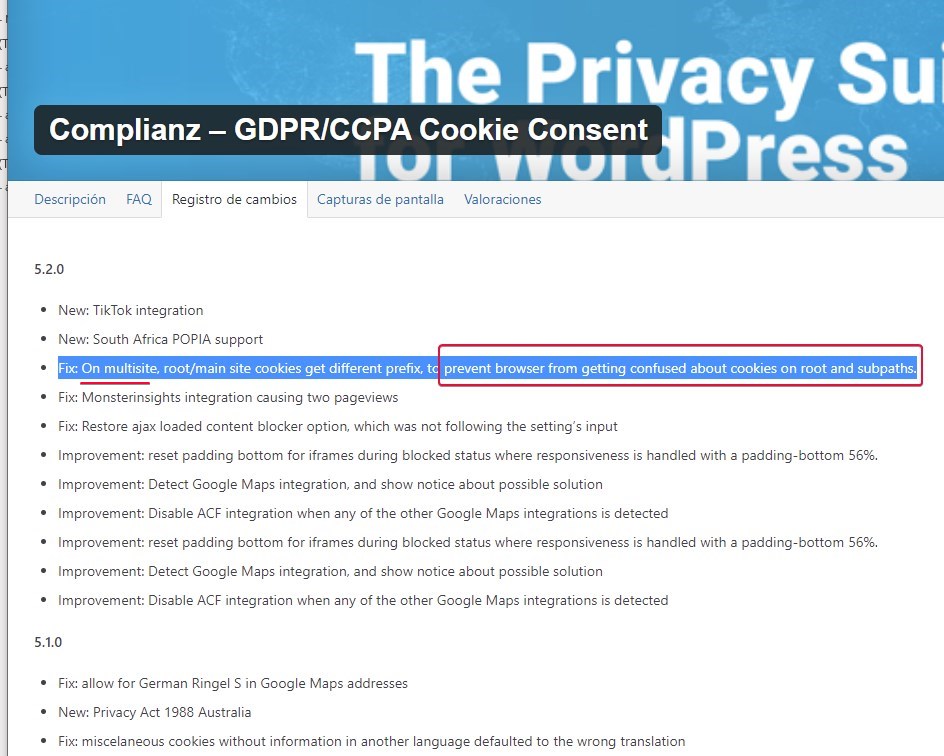

In reply to: [Complianz - GDPR/CCPA Cookie Consent] Consent banner keeps popping upIn another tread I was told that my solution is valid for sites that have single Complianz installation in a sub-directory, but our case having another Complianz in the root’s site, might not work, because of the way browsers handle cookies.
So, I think there seems to be easy solution for this; either use another cookie controll software, to avoid colsions, or migrate the web to it’s own domain.
In reply to: [Complianz - GDPR/CCPA Cookie Consent] Consent banner keeps popping upThanks @rogierlankhors. Mine is not a WP multisite installation, but simply 2 Complianz installations, in the root and subdirectory.

Now I have realized that it still fails. Basically, once you set the sub-domain cookies it forces the root site to set the cookies again, and from then on the banner ALWAYS repeats on the sub-domains site. If set first the root cookies and then the sub’s ones, but dont’t refresh the root cookies, the the sub’s banner works correctly

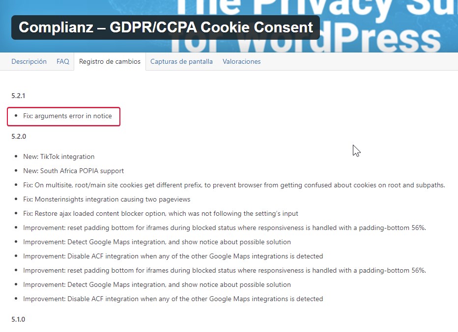

This is no WP multisite intallation, but even though I tested the today’d releases of Complianz 5.2.0 and 5.2.1, but none solved the problem.

I also tested the today’d releases of Complianz 5.2.0 and 5.2.1, but none solved the problem.
