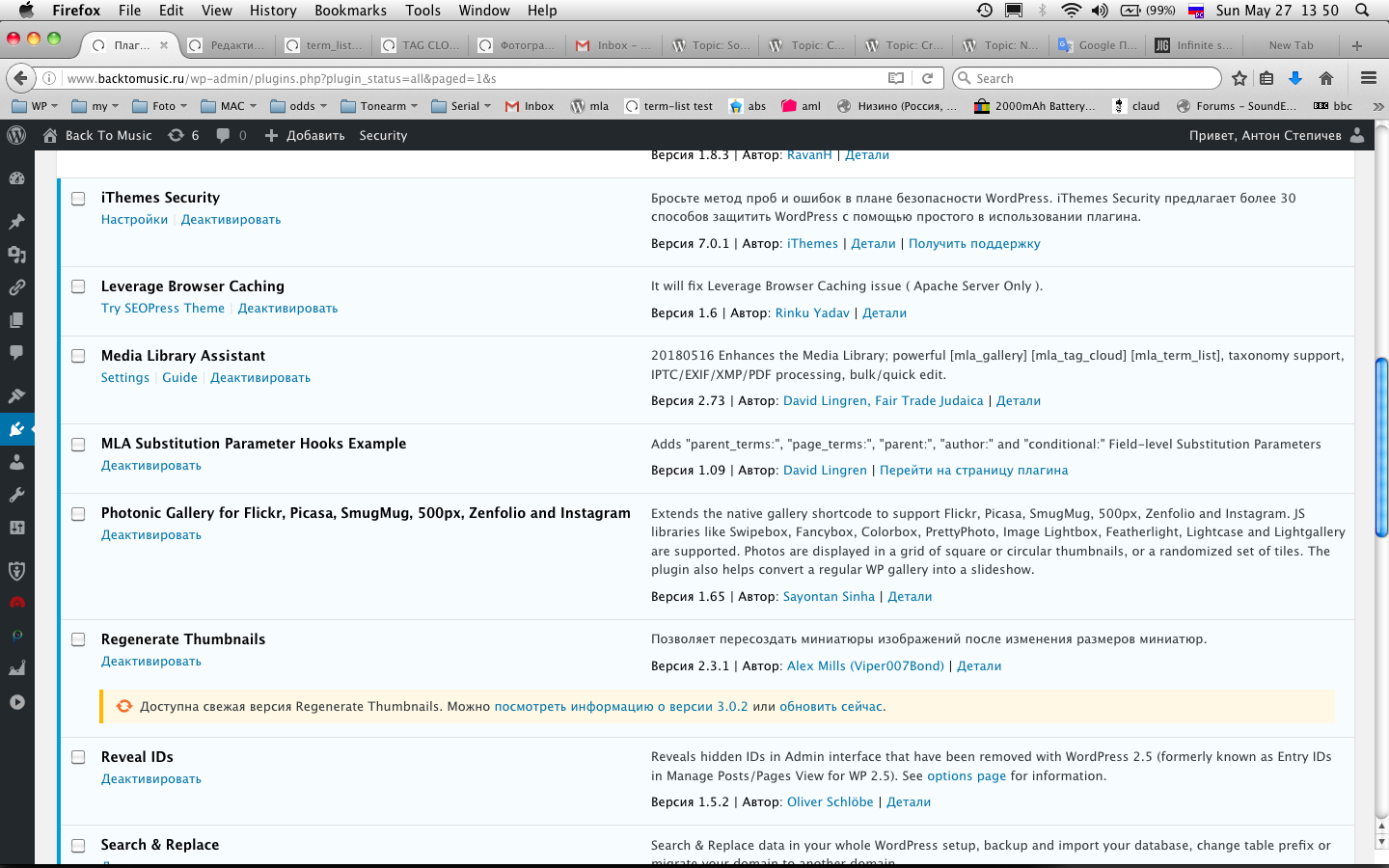

    Thread Starter antonstepichev
    (@antonstepichev)
    Hello David and thank you for your reply!
    As you suggested:
    – I deleted the extra MLA plug-in
    – added the parameter “Ids = 0” to the second shortcode
    – convinced that the plug-in “MLA Substitution Parameter Hooks Example” is active (see screenshort http://www.backtomusic.ru/wp-content/uploads/2018/plugins.png).
    Unfortunately, nothing has changed. Maybe the code does not work because I use WordPress 4.8.6 and not 4.9.6?
    (@antonstepichev)
    Hello David!
    I did everything according to your instructions and now I have the following components of the MLA installed:
    1 – Media Library Assistant – 20180516 Enhances the Media Library; powerful [mla_gallery] [mla_tag_cloud] [mla_term_list], taxonomy support, IPTC/EXIF/XMP/PDF processing, bulk/quick edit. Версия 2.73
    2 – MLA Substitution Parameter Hooks Example – Adds “parent_terms:”, “page_terms:”, “parent:”, “author:” and “conditional:” Field-level Substitution Parameters. Версия 1.09
    3 – MLA Term Links Example Adds “term_links:” Field-level Substitution Parameter prefix. Версия 1.01
    I added the new code to the page http://www.backtomusic.ru/uc/ulist-test-page, unfortunately it did not work and instead of the category name on top of the gallery the following code is displayed:
    {+CURRENT_TERM:ATTACHMENT_CATEGORY.'»BW_REF»'+}
    As much as I can understand, to enter a category manually is an intermediate stage? After all, the idea was that the category name should be displayed above the gallery automatically after the user selects it in the dropdown menu.
    In any case, thank You for your trying. Again it happened that I asked you a question that took you a lot of time. Please be free to answer whenever you want, I am not in a hurry. Hope that at least it will help you to develop your great plugin.
    PS – I have a question on the dropdown menu. In comparison with the tag-cloud, in the dropdown-term-list we have an additional action – pressing the button “submit”. Can I customize the dropdown code so that the gallery is loaded right after clicking on the category (that is, to exclude the “submit” button)? The question is relevant only if it does not take you much time, if it is difficult then let it be as it is.
    Have a great travelling and thank You!
