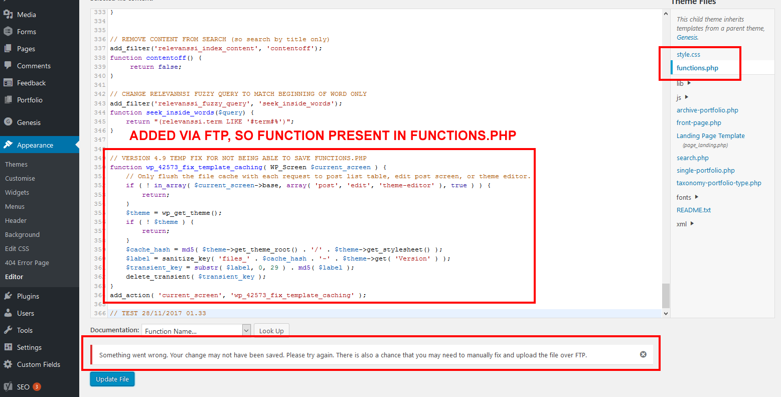

Forum: Fixing WordPress
In reply to: Can’t update template files in a child theme directoryAfter upgrading to 4.9.1 the issue still existed on my site (couldn’t save functions.php via the dashboard).
However, I deactivated all my plugins and found that I was then able to edit and save functions.php in my child theme.
Obviously then suspecting a conflict with a plugin, I reactivated them a few at a time, each time checking that I could still edit/save functions.php (which I could).
Upshot is that after doing this I failed to find a conflicting plugin, and ended up with exactly the same plugins activated. I made no configuration or setting changes to any of the plugins – other than having to remake the connection to the Jetpack plugin.
This may be of help to anyone with the same issue.
In reply to: Can’t update template files in a child theme directoryHello James
Thank you for your reply and link to the plugin.
Unfortunately the plugin didn’t resolve the issue for me – I tried it uploaded as a plugin and then adding the code directly to functions.php (via FTP).
Regards, Ash
In reply to: Can’t update page templates on TiptonIn addition to my previous post:
The issue also exists using the 2017 theme.
The HealthCheck plugin reports the filesystem permissions as follows:
The main WordPress directory Writable
The wp-content directory Writable
The uploads directory Writable
The plugins directory Writable
The themes directory WritableWhat I’ve also seen is that the WordPress dashboard under APPEARANCE > EDITOR doesn’t recognise any new files uploaded to the child theme directory. For example, I uploaded a file named functions-test.txt to the child theme directory, but there’s no reference to it in the dashboard (screen capture here).
Regards
Ash
In reply to: Can’t update page templates on TiptonI have the same issue with two sites on the same server (NGINX environment) unfortunately as receiving the error message below when trying to save files like functions.php from my child theme.
Both are established sites that haven had any issues like this before the upgrade to 4.9
“Something went wrong. Your change may not have been saved. Please try again. There is also a chance that you may need to manually fix and upload the file over http://FTP.”
