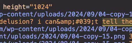

    i took a look at what it’s doing and you’re only encoding it once but it’s doing it again inside the dom conversion — only for &, though. even if you manually disable double-encoding, it still does it. but if you disable the encoding line altogether it doesn’t do it even once. very odd behavior but not unexpected, given how weird the mess of how wordpress stores html content. i don’t have a quick fix for you but i hope that helps.

    thanks so much for all that work! i’ve been using it and it’s wonderful. there is one bug with one of the fixes i figure i should point out. when using a special character like an apostrophe, it edits and saves it correctly without all the backslashes but it gets the html version messed up when it actually displays on the wordpress end. i’ll attach a couple of screenshots.
    this is what it looks like in the inline editor.
    and this is what it looks like in the generated code on the site.
    so, instead of turning it into “'” or “@apos;”, it’s turning the & escape character and calling that “&” inside the “'”.

    the issue with the escaping is about the difference between html escape characters and sql escape characters. they only need to be escaped if they’re problematic for sql (single quotes, double quotes) and you can avoid that problem completely by converting them to their html equivalents and back. then you never get a sql error on mismatched escapes. if you swap ” to " and ‘ to ' when storing to the table and the reverse when loading, pretty much everything else can just remain. there would be issues with other special characters like \ but those aren’t even functional for most alt-text purposes so they could probably be stripped just like linefeeds.
