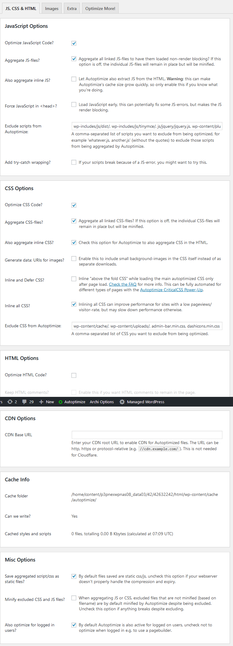

In reply to: [Autoptimize] “Exclude Scripts” Not WorkingFixed it. Turns out I just needed to exclude jpreLoader.js. For some reason, all my other scripts were depending on that.
Thank you for the help!
In reply to: [Autoptimize] “Exclude Scripts” Not WorkingI tried that but no change. And it is active, or at least supposed to be: http://loftstudiointeriors.com/wp-content/uploads/2019/08/Screenshot_2019-08-10-Autoptimize-Options-%E2%80%B9-LOFT-Studio-Interiors-%E2%80%94-WordPress.png
