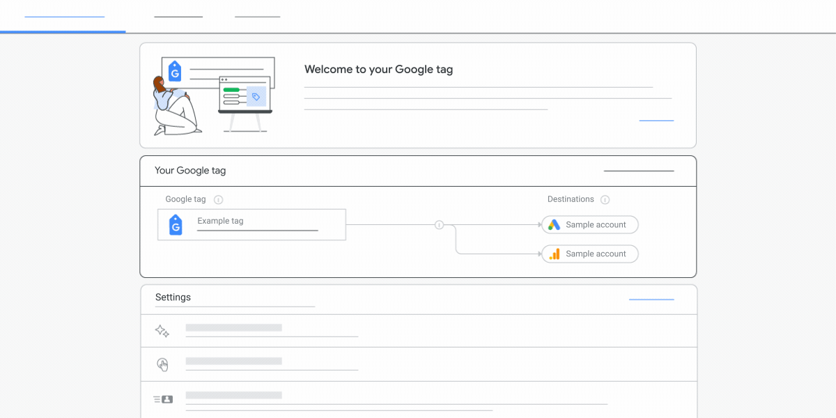

In reply to: [Joinchat] Google Analitycs events missingIndeed, if GA4 is configured as an extra destination in another Tag (Google Ads or other) the Joinchat script does not detect it.
For now, the solution is to explicitly add the GA4 property in your script. e.g.
<script> window.dataLayer = window.dataLayer || []; function gtag(){dataLayer.push(arguments);} gtag('js', new Date()); gtag('config', 'AW-999999999'); gtag('config', 'G-999999999'); // Add this line with your GA4 Measurement ID </script>Forum: Plugins
