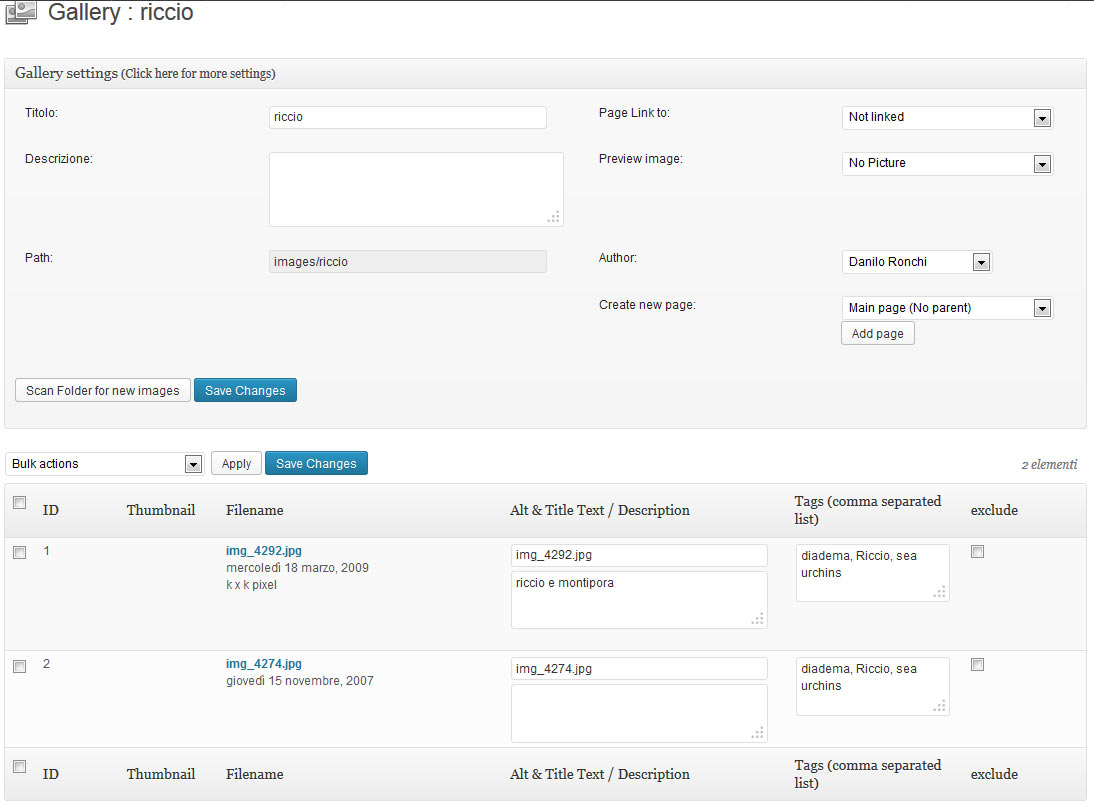

Same issue here… slash missing and all pictures not linked anymore…
Thanks I’ll try
as you can see here: http://www.danireef.com/wp-content/uploads/2013/09/Senza-titolo-1.jpg
the path is “images/riccio” that is correct
but if I click on the name of image i find this: http://www.danireef.com/imagesriccioimg_4292.jpg that is wrong.
If I click on scan I obtain nothing.
Any helps?
If I go in the “manage galleries” section, and I open one gallery I can see the path in the upper part of the page that is correct, but when I see the images, the path is incorrect, because it’s without “/”.
