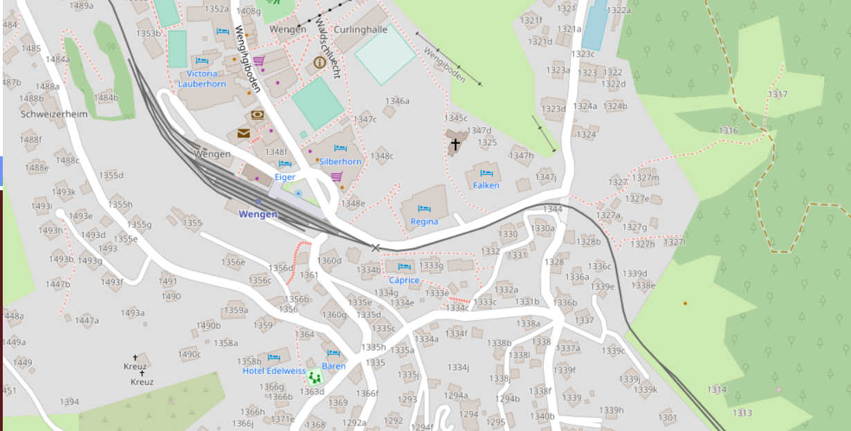

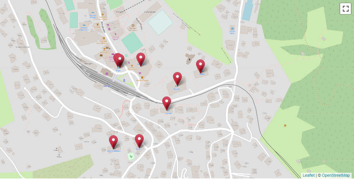

In reply to: [Events Manager - OpenStreetMaps] Zoomed in still gives grey screenOK I’m still not sure why it’s happening but by comparing my sites map with the default open street maps map of the same location I know what is happening – And yes it makes no sense :
The map displayed on screen is one level higher than what the screen display says, i.e if the screen says a zoom of 17 it’s actually displaying the zoom of 18, also it’s never loading the level 19 tiles I’ve worked this out by seeing what files are actually loaded and when and comparing them to the OSM page https://www.openstreetmap.org/#map=16/46.6036/7.9174
But to make matters more complicated the tiles are displayed at the zoom displayed magnification, that is to say that the level 18 tile features are displayed on a level 17 screen which is why all the text appears so tiny
So hear is the open street map image with a zoom of 17 https://www.downhillonly.com/wp-content/uploads/2019/09/osm-zoom-17.jpg
And here is the same location from the website with a zoom of 17 https://www.downhillonly.com/wp-content/uploads/2019/09/website-zoom-17.jpg
note how despite the two lining up exactly for the landscape features because the image from my website uses the tiles from zoom 18 to display at zoom 17 all the text is about half the size
