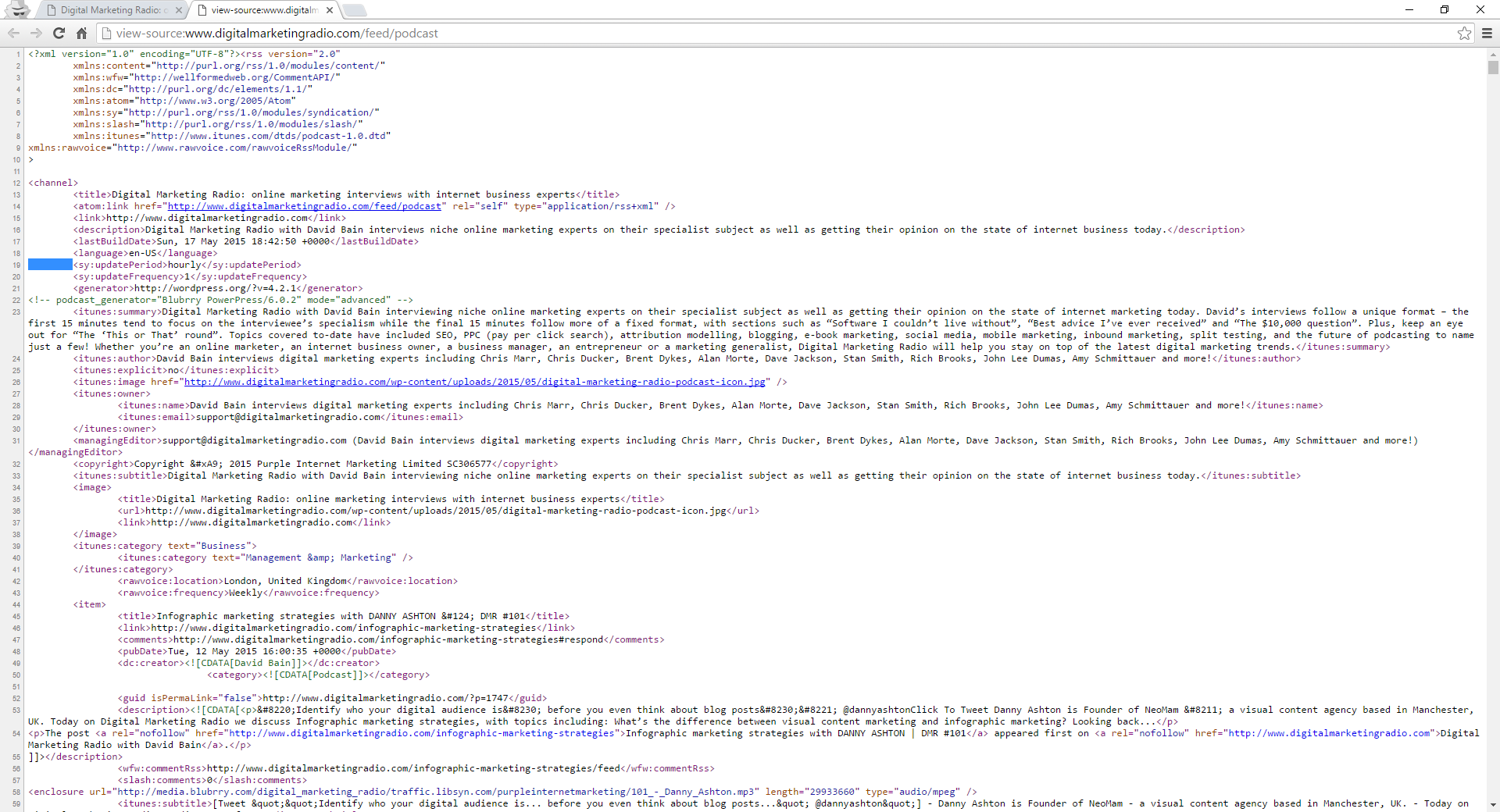

It’s definitely the feed that’s flipping back and forth between displaying all the episodes (1 to 154 at the time of writing) and just episodes 1 to 101.
If you look at the feed in incognito mode in your browser you’re more likely to see the 1 to 101 version. I guess that’s because of caching.

– My maximum number of items in my feed has always been set at 200
– The ‘feed maximizer’ option has also always been tickedYou also mentioned that you looked at my iTunes listing and it displayed all 157 episodes. Unfortunately this too sometimes reverts to only displaying the first 101 episodes.
I’m afraid it’s definitely the feed that appears to be the issue – check out this screenshot which I took a few minutes ago. It shows the latest episode as being episode 101.
This continues to happen sporadically – then it will revert back to displaying all the episodes.
