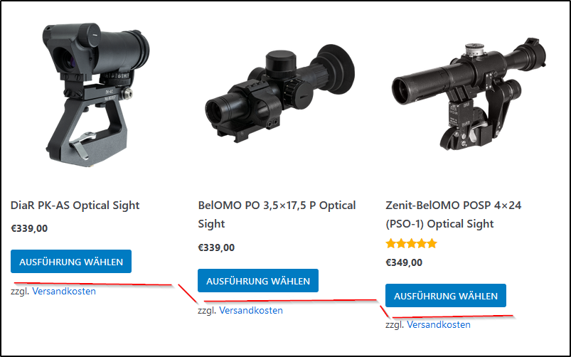

    Thread Starter durrmann
    (@durrmann)
    Hello @bvytis
    thank you for working on this issue!
    I have an example for you here. The products differ in their title length and one of them has a rating. this leads to this “stairs” effect:
    https://s12.directupload.net/images/201022/z6i4rv7l.png
    Thank you for your effort!

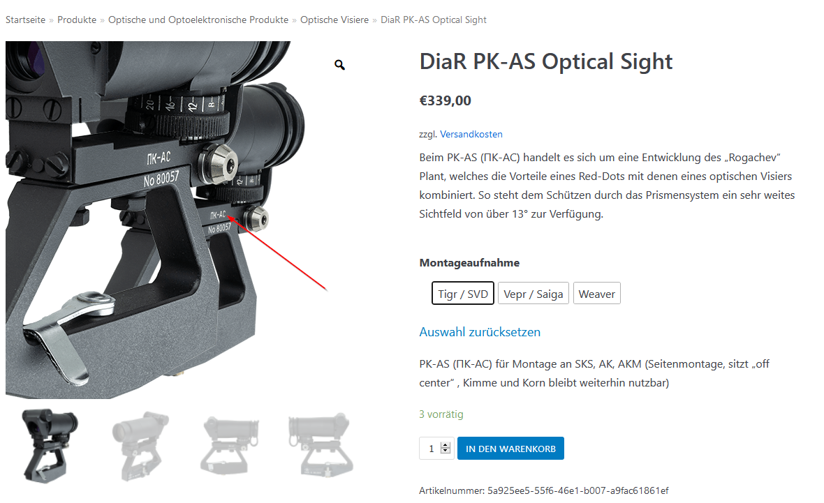

    (@durrmann)
    Hello @bvytis
    thank you for your reply. Attached you can find a screenshot:
    https://ibb.co/HGRGKjs
    You can see the magnified image of a rifle scope (After hovering over it). The same image is also visible in the background (in its original size).
    It would be great to see only the magnified version when hovering over the image and not the “two layers”.
    Hope it got a little bit clearer.
    Thank you!
