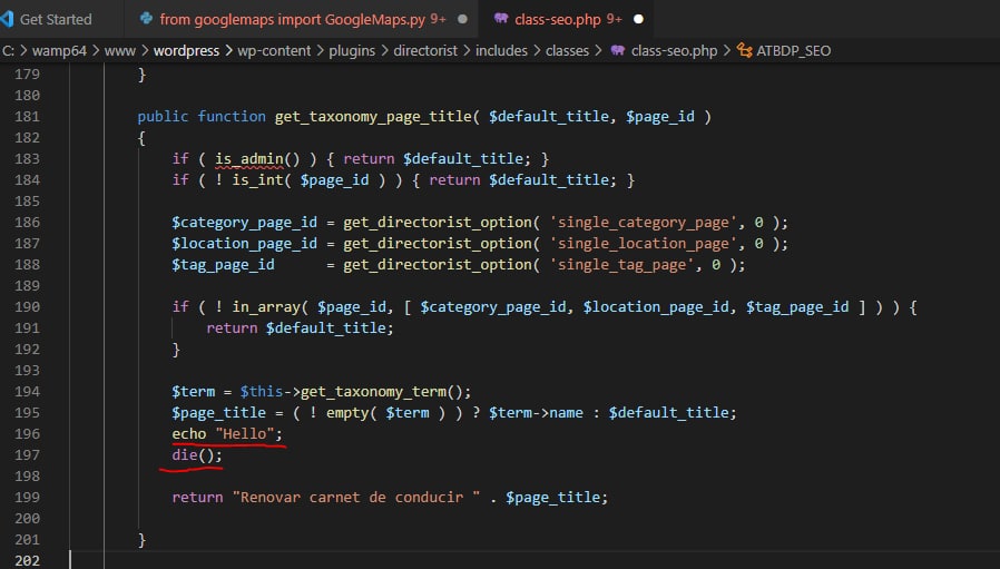

I tried on localhost with an older version of Directorist and worked, but couldn’t make it run on my hosting.
Here’s my code:
https://telegra.ph/file/1333d1678f51998afacf5.jpg
I even tried to apply a die() function and the public function get_taxonomy_page_title doesn’t get any calls, nothing happens.

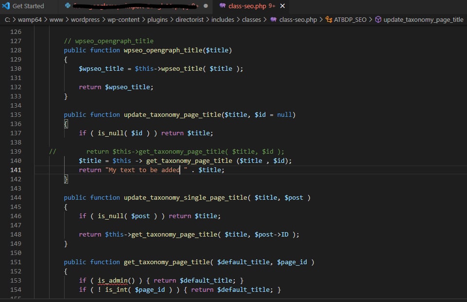

This is what I did:
https://telegra.ph/file/a8204e1145e46cd9b405d.jpg

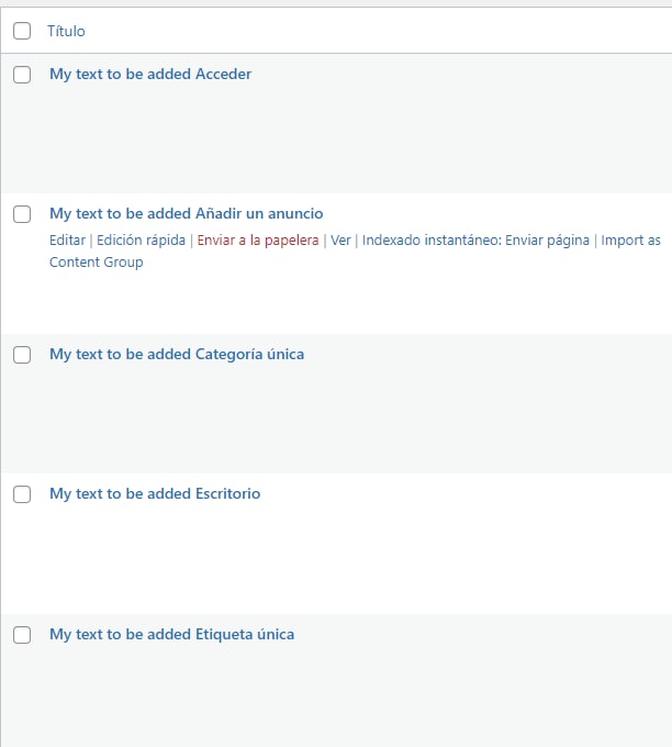

As you can see in the following picture, all pages get this piece of text added:
https://telegra.ph/file/b9288dabfafccb82744b4.jpg
Thank you for your patience. Seriously 🙂
Finally I tried the piece of code in a different place and it worked, but didn’t get the result I was expecting.
I need to add certain piece of text to the title of the taxonomies ‘locations’ and ‘categories’. Instead, that code substitute all page and taxonomy titles for the text inserted.
