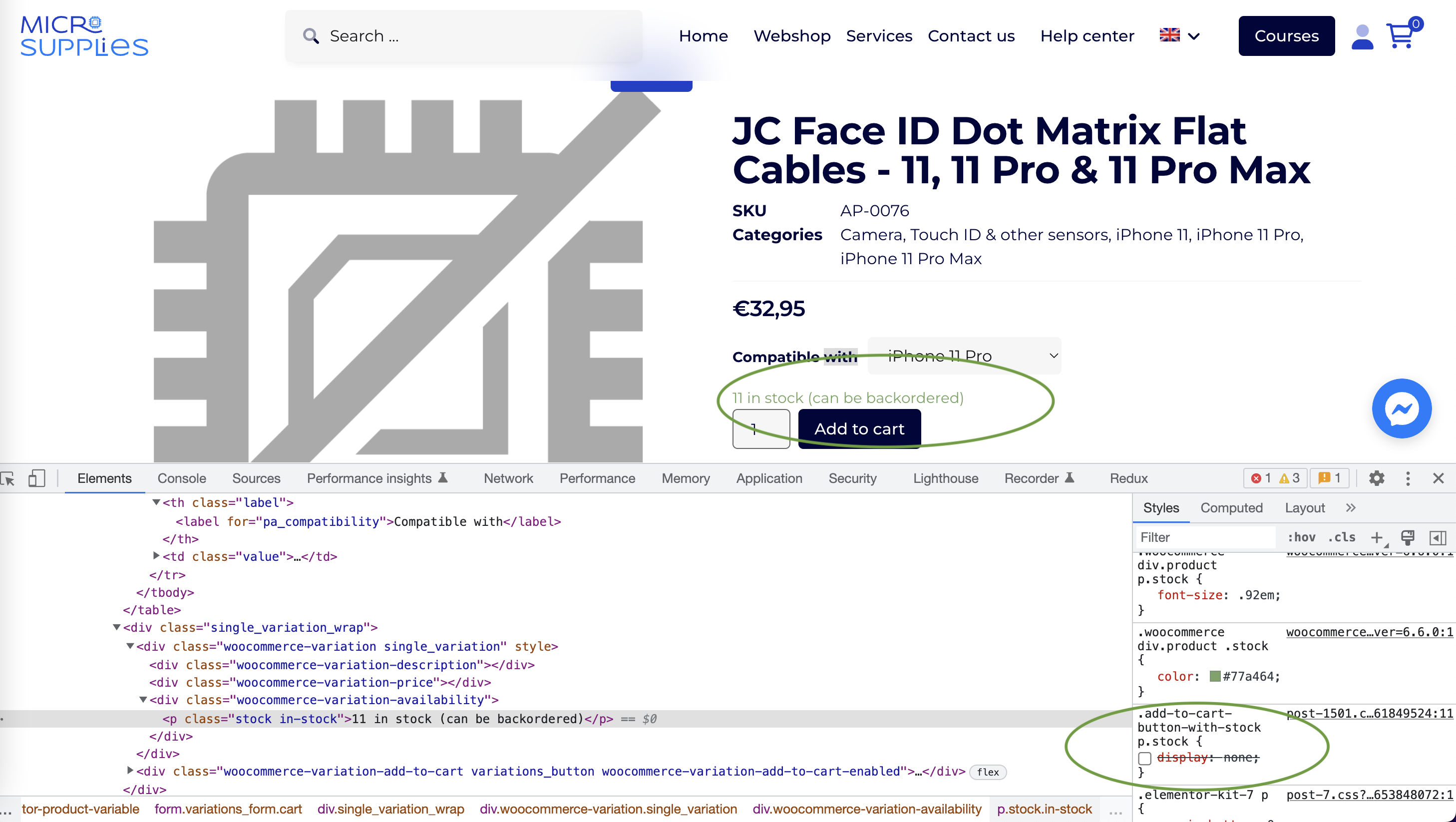

In reply to: [WooCommerce] Stock per product variationHey @unrealpixel
I can see some custom CSS (styling) on that page that seems to be explicitly hiding the availability of your variations.
This seems to be coming from Elementor — have you perhaps configured Elementor in a way that could explain this?
Cheers,
