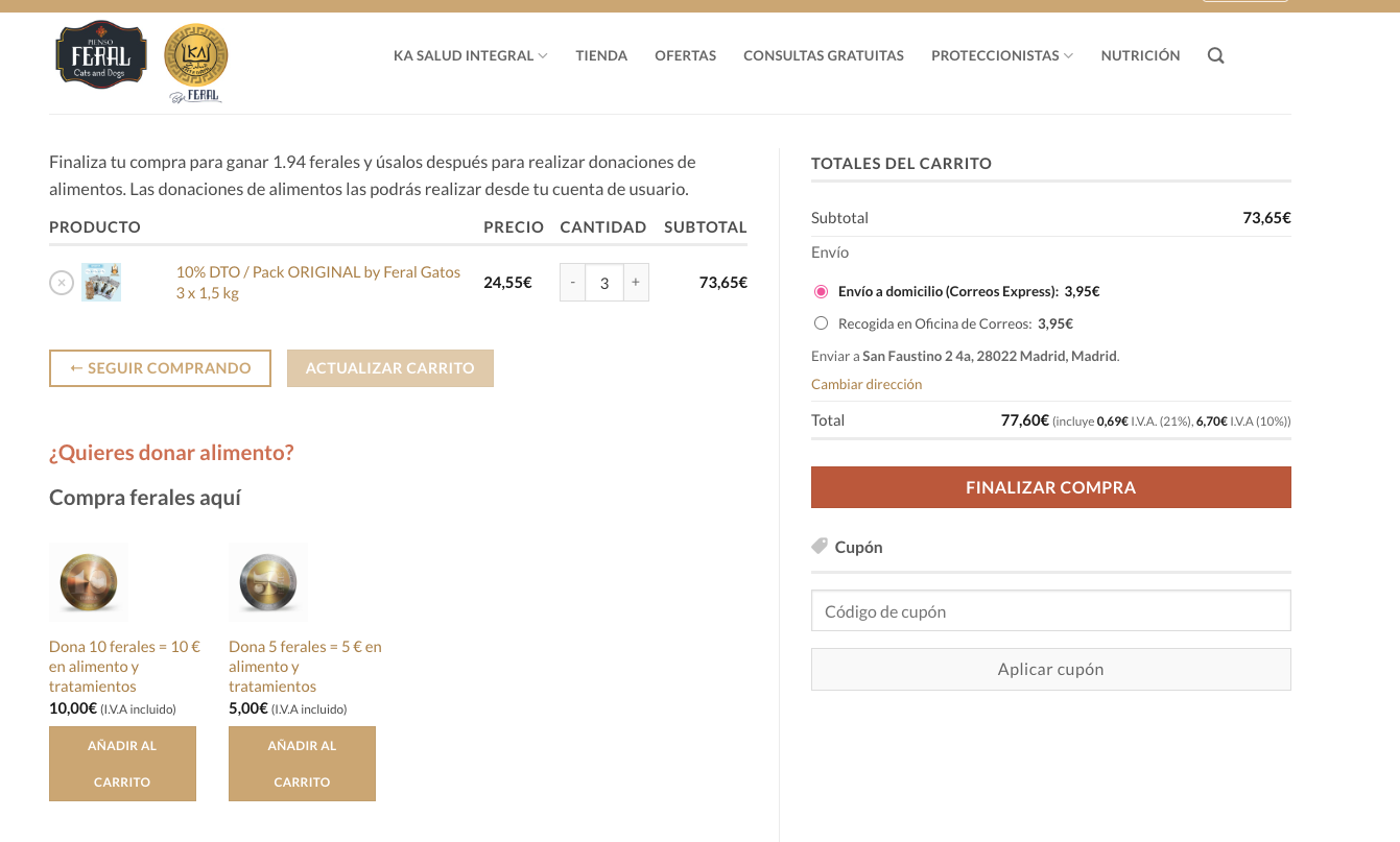

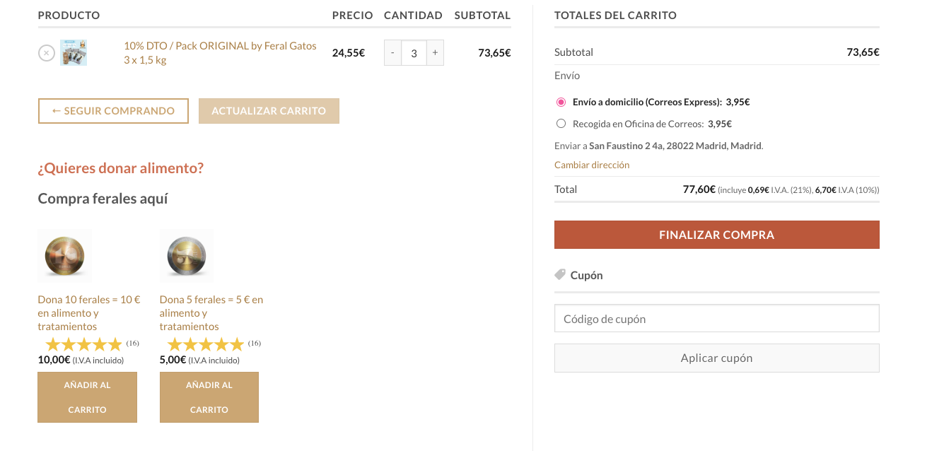

In reply to: [WC - APG Weight Shipping] Price calculation changes on every updateOrder total is in euros, and the price of the bundle is 24€. I select 3 units of that bundle, see the screenshot
https://media.urbanistnetwork.com/urbanist-travel/temp/image%20%2816%29.png
I configured so above 55€ the delivery is free, should return Tarifa seleccionada:Array ( [sin-clase] => 0 ) but it returns Tarifa seleccionada:Array ( [sin-clase] => 3.2645 )
and based in [todas] => 0 means that no matter how many I add the sum is 0 for that bundle total.

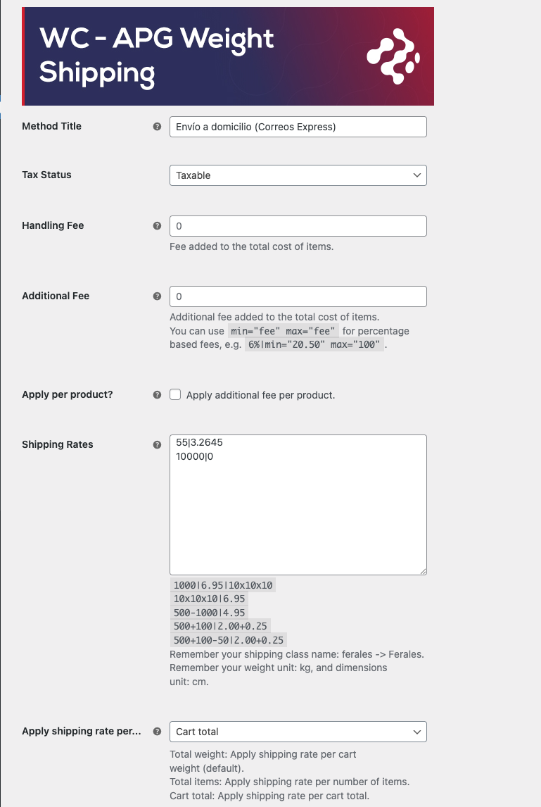

In reply to: [WC - APG Weight Shipping] Price calculation changes on every updateyeah I don’t know why it shows so small. check these
APG config
https://media.urbanistnetwork.com/urbanist-travel/temp/image%20%2812%29.pngProduct config
https://media.urbanistnetwork.com/urbanist-travel/temp/image%20%2813%29.png
https://media.urbanistnetwork.com/urbanist-travel/temp/image%20%2814%29.png
https://media.urbanistnetwork.com/urbanist-travel/temp/image%20%2815%29.png
In reply to: [WC - APG Weight Shipping] Price calculation changes on every updateWell that’s another issue, the plugin is configured to calculate in cart totals, in euro. It actually works with other products, I just suspect the debug output is wrong, as it matches the cart total, not the weight totals.
This is the config

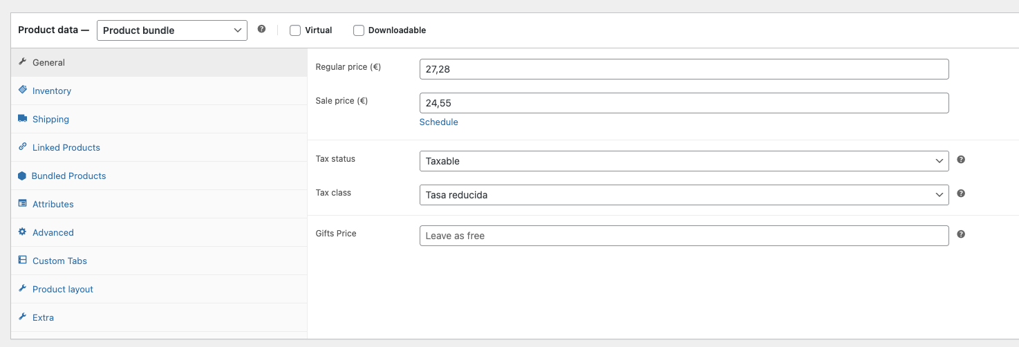

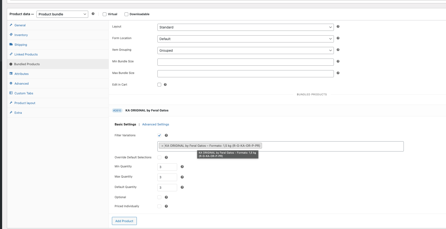

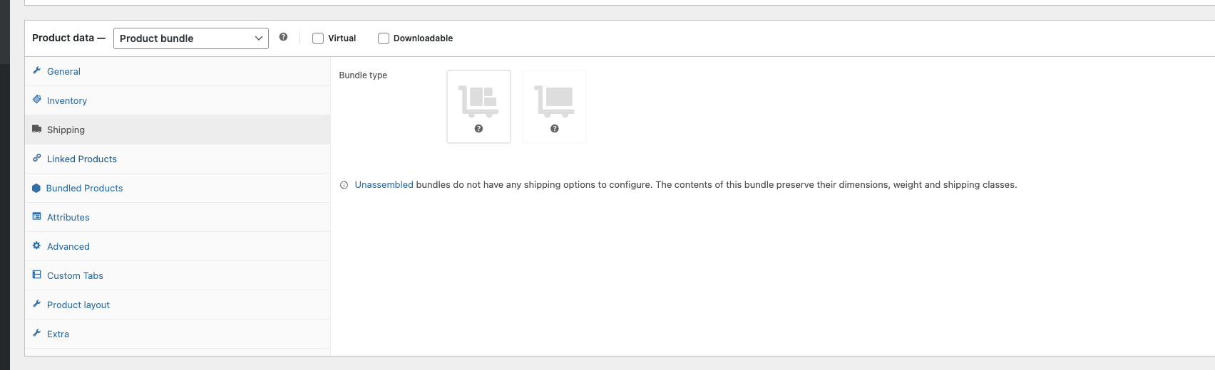

In reply to: [WC - APG Weight Shipping] Price calculation changes on every updateI think I found the culprit. When I add to the cart a product Bundle (plugin WooCommerce Product Bundles) the totals got messed.
if you try to include this product, https://kasaludintegral.com/producto/10-dto-pack-original-by-feral-gatos-3-x-15-kg/
the prize always sums 0, therefore the error in calculation. I included 3 for the debug. But it works well for other bundled products. I don’t understand why. The configuration of the bundle is correct.
