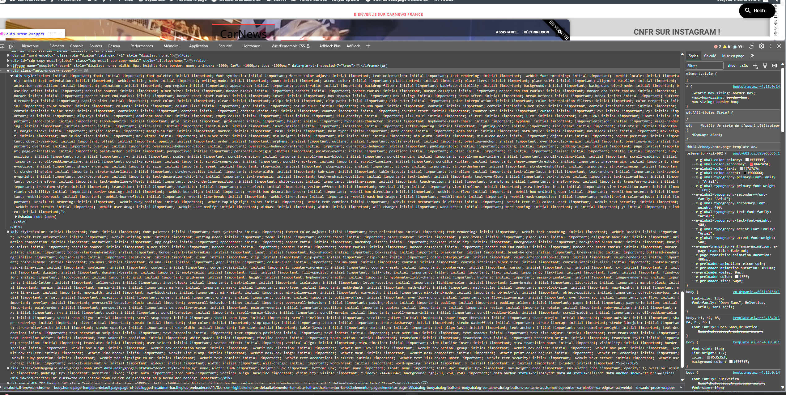

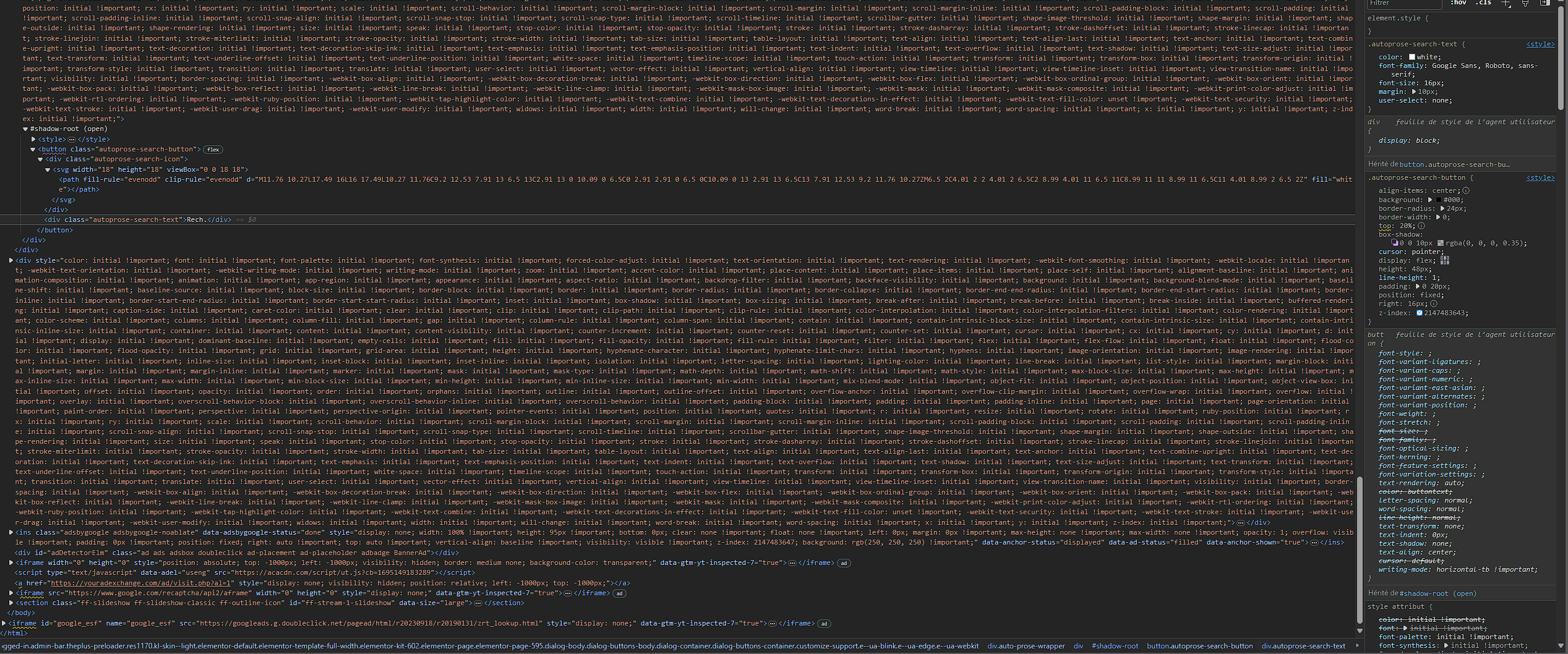

Hello, here is the code when i used with inspector element from navigator Edge/ chrome :
https://zupimages.net/up/23/38/ng6t.png
https://zupimages.net/up/23/38/2uty.png
auto-prose-wrapper it’s the name of element for search bar
and it from : show_ads_impl_with_ama_fy2021.js?client=ca-pub-9154160301755770&plah=carnews-france.fr =
