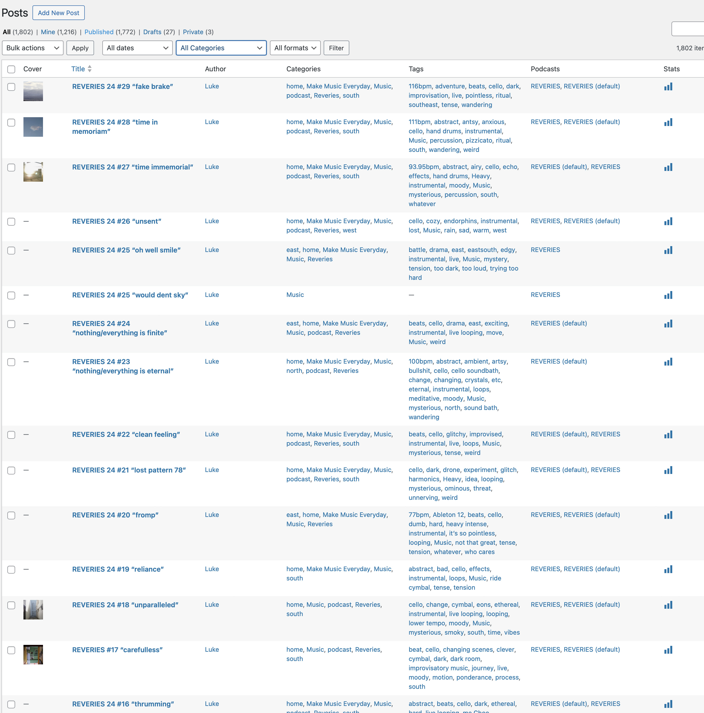

    I finally consolidated all podcast episodes into a single default podcast.
    Same issues persist: clicking on the number beside the name of podcast (696) shows only 7
    If I go to “All Posts”, however, and click sort by/filter the column “podcast”, it properly shows all podcast “posts”

    When I go to “Posts”, under the ‘Podcast’ Column there are hundreds, as indeed, most of my 700+ posts for last 7 years or so are podcast audio.

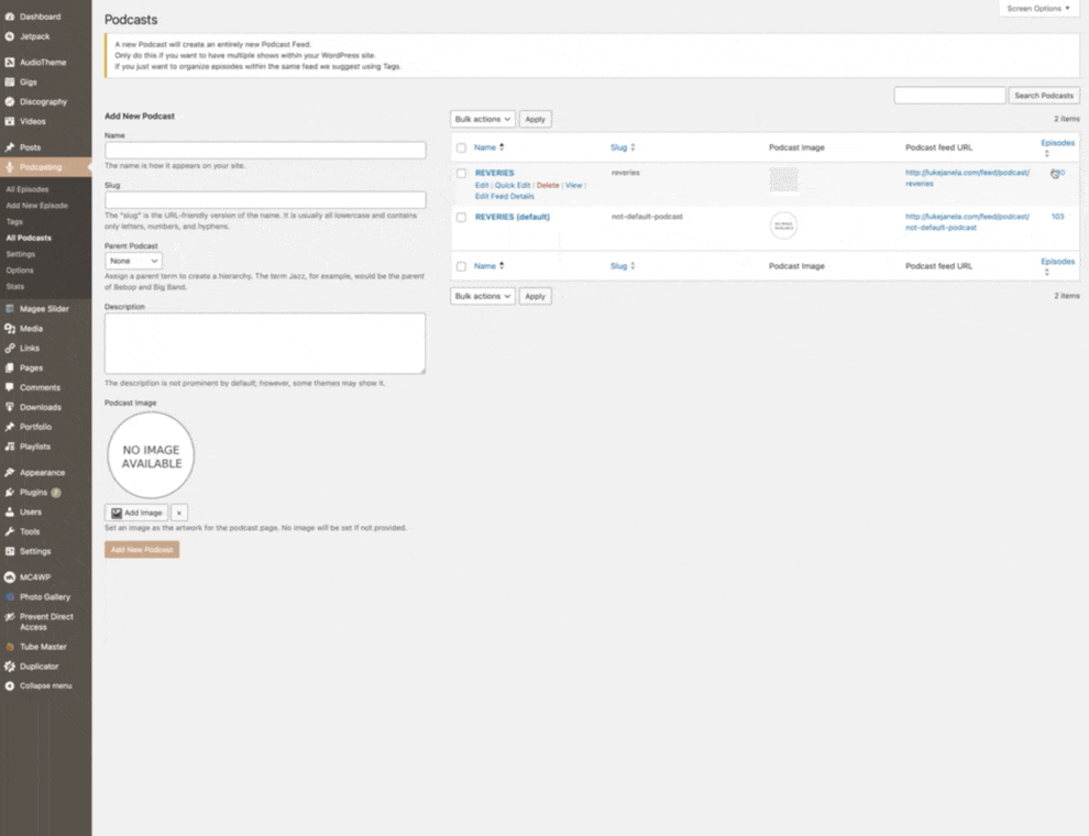

    perhaps an issue (that I haven’t yet had in 5+ years) is that i need to combine the “default” podcast with the much more heavily used “not-default” podcast.
    How could I do this and not disrupt people’s experience with my feed?
    Attached are screenshots, one of what I mean by default and not default, and another of each podcast’s settings/options.
    Along similar lines, if I try the “turn it off and turn it back on again” approach of re-installing seriously simple, is there a way to do so without interrupting subscriber’s experience?
    I realize this is a little vague as I don’t know what I am talking about, and I appreciate your responses. Hopefully I can get this sorted without having to bug you much. Cheers!
    And just to clarify for help troubleshooting: these problems started in the past month or so with no changes on my end. I rarely, at this stage in my site/podcast, make changes, add plugins etc.
    two podcasts which I don’t need… how to “combine”?
    The podcast that I have been using all this time options/settings:
    the podcast that is labeled “default” but which i don’t and haven’t been using
