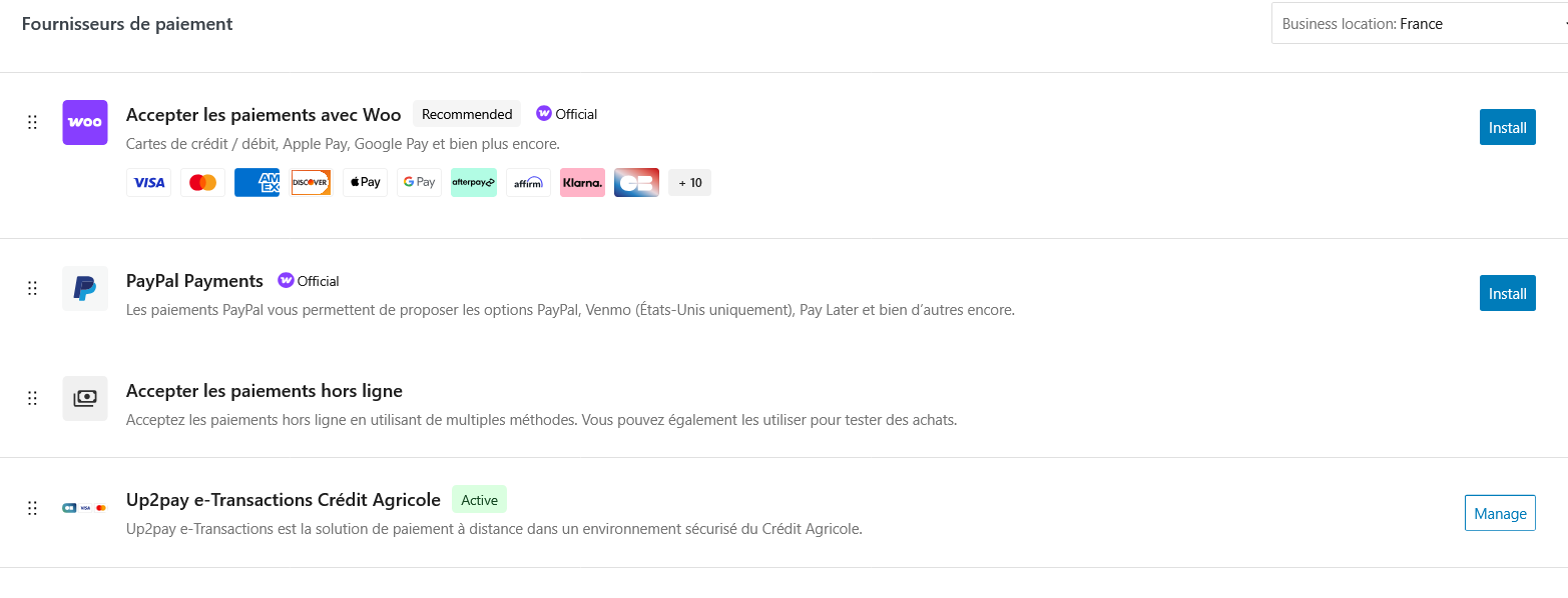

In reply to: [WooCommerce] “It seems there are no payment methods available.”Hi, thank you very much for your answer.
You can find the screenshort at https://lesideesnet.com/Screenshot-2025-07-05.png
and the report at https://gist.github.com/lesideesnet/4f67a4d9b711046408513de67430904dThe (very) strange thing is that everything is working when I’m connected at an admin…
Notre that psaaa_ are other tables in the SQL base, which are not related with this website.
Thanks in advance
Philippe
