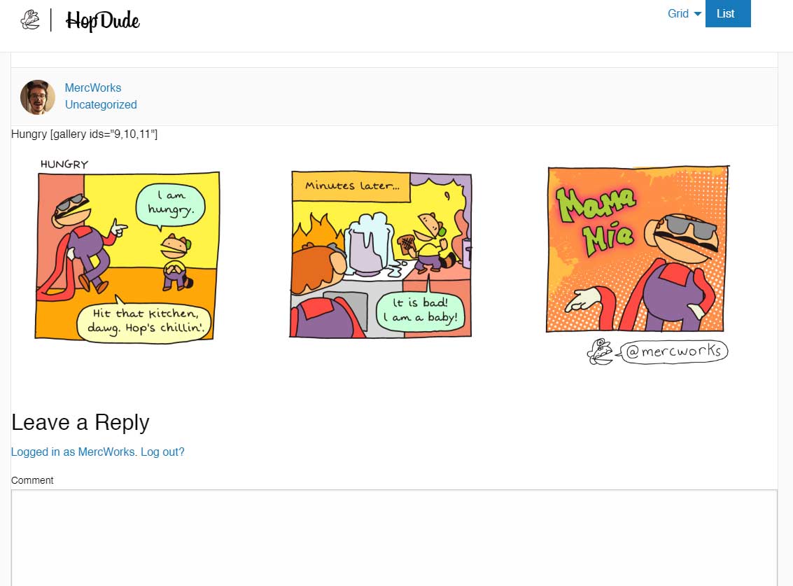

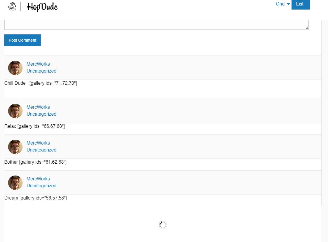

In reply to: the_content doesn’t display when loaded with AJAXHi @sjaure! Thanks for the prompt reply.
AJAX is definitely working okay. If you try the grid view, you’ll see that the AJAX returns data fine and gets the first image of each post using a custom get_first_image function, rather than the_content. In the list view where I’m having the issue, it returns data but does not display the_content.
So, here’s an example:
This is the list view, loaded without ajax. Note the full comic, which is being loaded via the_content()Here’s the same view, after loading the AJAX content. You can see the gallery shortcode, which is being called by echo $content = get_the_content();, but no comic!
So, the problem is definitely that the_content() is not displaying when loaded via AJAX. I -suspect- it may be related to the custom gallery filter I’ve got kicking in functions.php, but I really don’t know.
