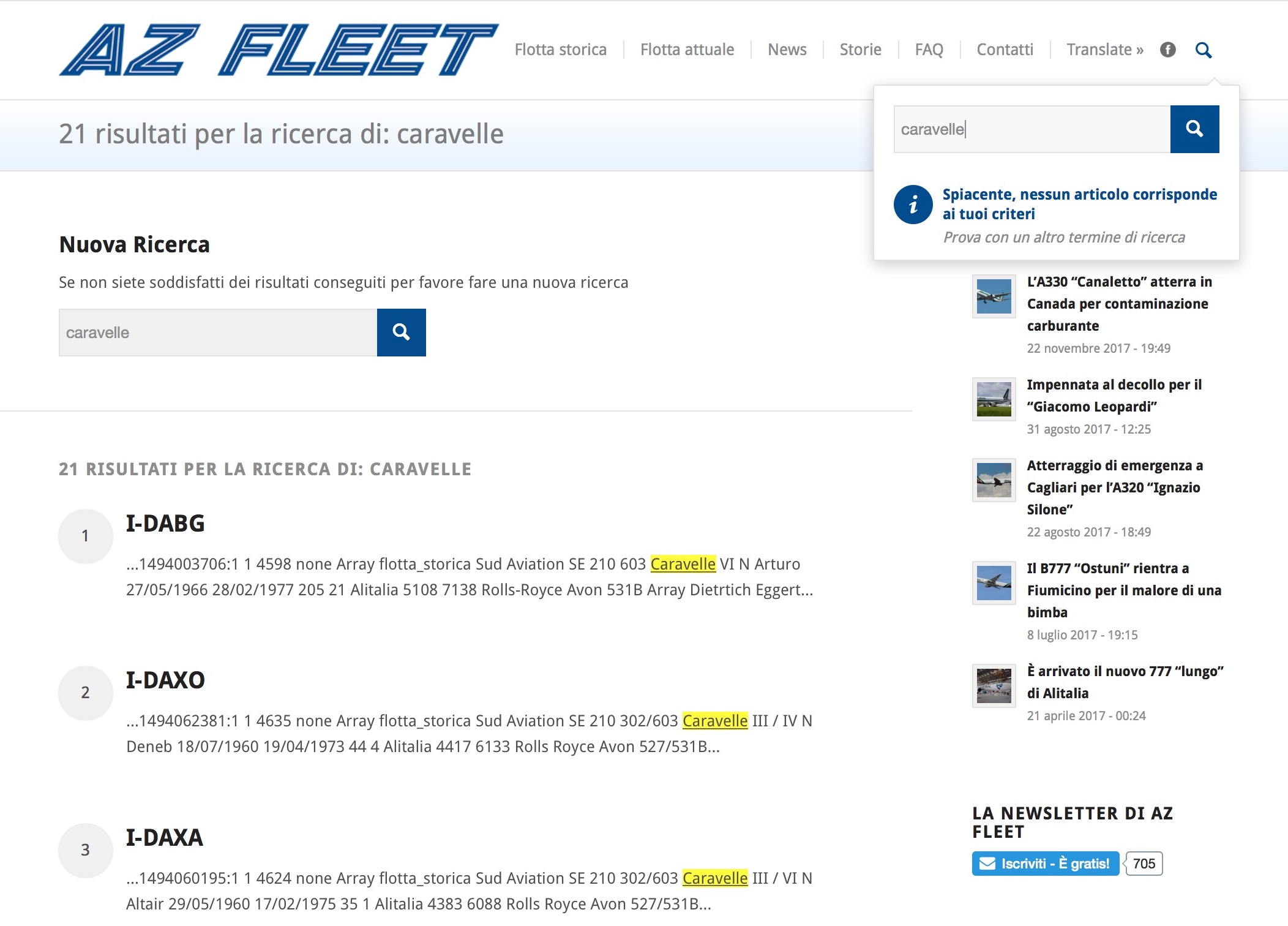

In reply to: [Relevanssi - A Better Search] Problem with Enfold theme “Instant Search”Hello Mikko,
here is what the developers say there is inside the $tempquery function:An here is a screenshot showing the striking difference between the results (21 to nil) on a full Relevanssi-driven search and an Ajax search:
http://www.azfleet.info/docs/azf_relevanssi.jpg
I hope this helps!
- This reply was modified 8 years, 5 months ago by Nightjar.
In reply to: [Relevanssi - A Better Search] Problem with Enfold theme “Instant Search”I have asked the theme’s developers info about that $tempquery variable, In any case, they wrote:
“Yes, unfortunately, the theme’s ajax search uses the get_posts function to query posts.”
Does that mean that there is no way out of this loop for ajax search?
