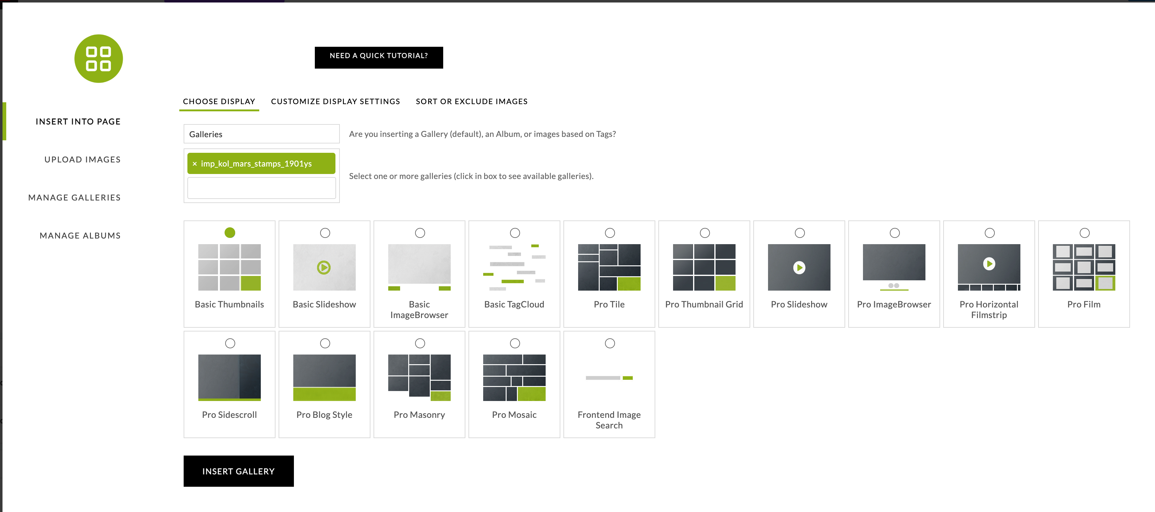

While the dev team is looking at that issue, having a large number of galleries causes a similar issue with the block to add a gallery (the one shown here).
If you have a large number of galleries, the pop-up becomes unresponsive for a time when you open it. I have about 2,000 galleries, and I have to wait about 60-75 seconds for it to become responsive before I can do anything with it. It’s not fatal because it does work, it just takes several minutes to accomplish tasks that should take a few seconds.- This reply was modified 2 years, 5 months ago by PostmasterGS.
