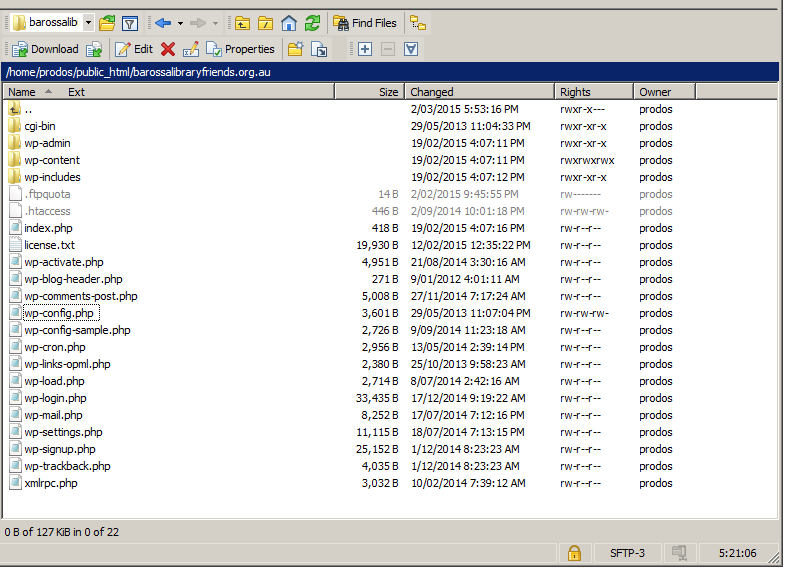

Greetings.
Sorry, but I don’t see either php.ini or .user.ini at that location.
Here is a screenshot of what I can see
Your further advice would be appreciated.
Thanks.
Best Wishes,
PRODOS
