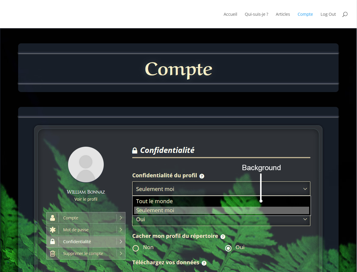

    Sorry for the broken link Image 3

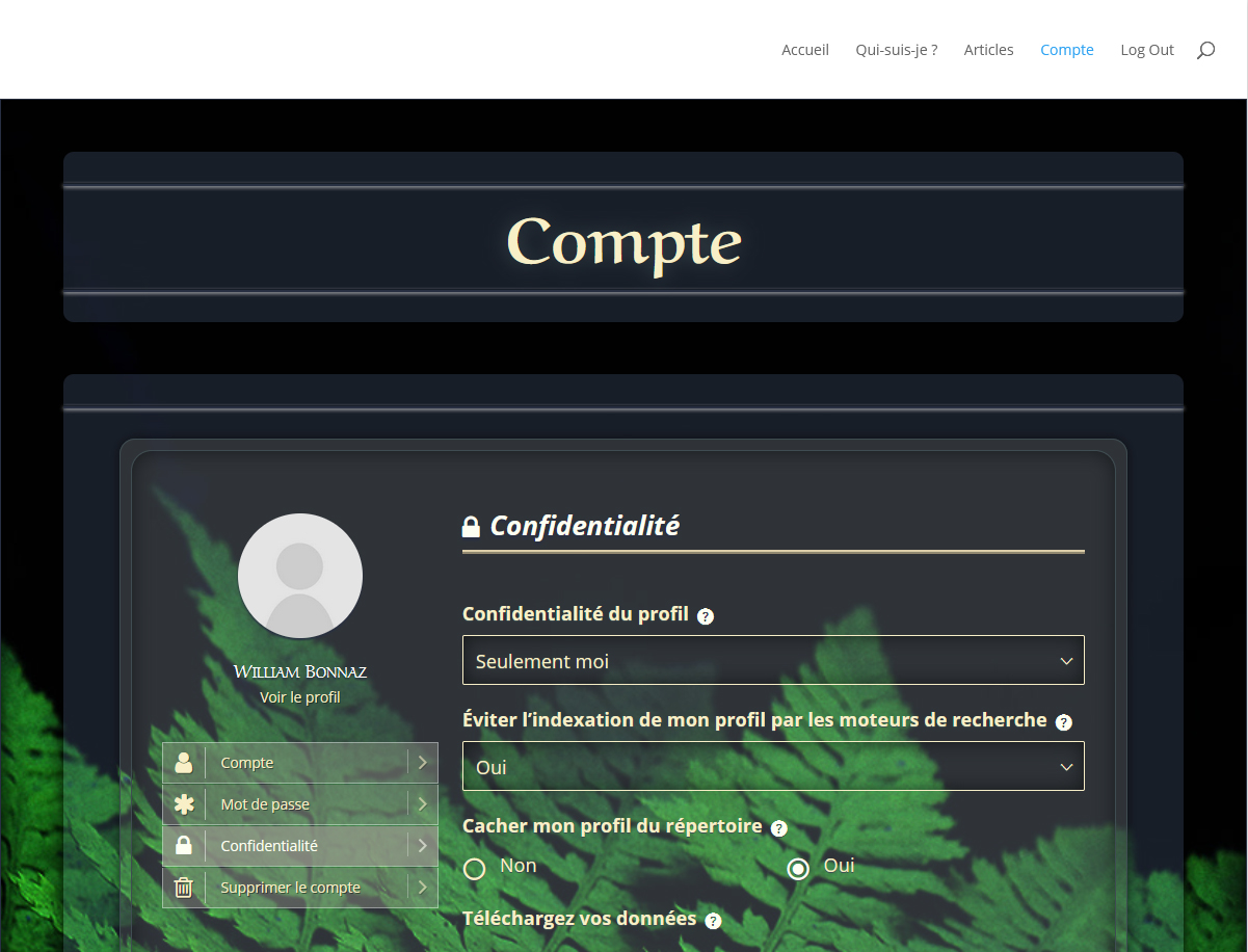

    Image 1: My page, when loading.

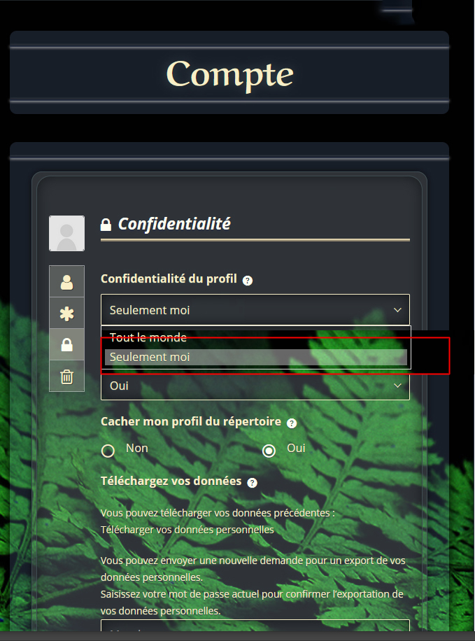

    Image 2: I unfold the first selection list … Note that behind I have inserted a background.
    Image 3: When I resize my window, the list does not collapse (While it collapsed in the previous version). Suddenly, my background, which was erased with the list which collapsed, remains visible.
    - I tried to resize my background, in 'live', but it never correctly matches the edges of the selection list (with JQuery and the CSS clip method) ;
    - I noticed that a 'click' in the bottom of the document; Pressing the 'esc' key or the 'tabulation' key correctly hid the displayed list. I tried this approach, when resizing the window. But, obviously for security reasons, browsers no longer allow you to simulate the action generated by pressing a key using .trigger ("click") or other methods ;
    I also tried, with JQuery, to remove class and attributes on the tags to try to restore the drop-down list to its initial state, but without success. If I manage to hide the list, the list no longer works afterwards. The list seems blocked: no more highlighting when the mouse is hovered and no more selection possible. The list just opens and closes
    I attach you the part of my JQuery code assigned to this task. Forgive his inaccuracy, I'm not a seasoned pragrammer .
    You have changed the structure of your code. I was able to correctly reinsert my background where I wanted. The problem is mainly due to the fact that the list, in the previous version, was collapsed when the page was resized and it is no longer !
    And if I am asking for your help, it is because I am pressed for time, within the framework of my exam ...
    Thank you in advance for your attention to my problem.
