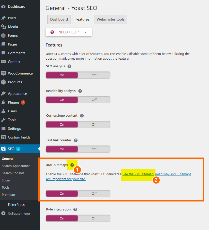

    @knowjoby Go to General > Features > XML Sitemaps and click the question mark next to it. Then click “See the XML Sitemap”. Note that you might need to go to Settings > Permalinks if that page is not found (that’s the issue I described in my last comment).
    Also see here:
    https://s3-us-west-2.amazonaws.com/elasticbeanstalk-us-west-2-868470985522/ShareX/2018/03/chrome_2018-03-08_18-07-23.png

    I usually enable it to edit the sitemap settings. I see there’s a box to toggle sitemaps in “Features” now. That wasn’t working so I was trying to turn it on.
    Now I see they are enabled I just tried flushing permalinks and it fixed the problem, I just thought they were disabled! Although yoast should probably flush the permalinks when the plugin gets activated for the first time, this was a fresh install and sitemaps weren’t working even though they were active.
    There were previously options to toggle which post types and taxonomies appear in the sitemap before though, I don’t see that anymore. Is that still available? Honestly I rarely used it so a functions.php alternative would suit me just fine if possible. What would you recommend for when I need to adjust that next?
