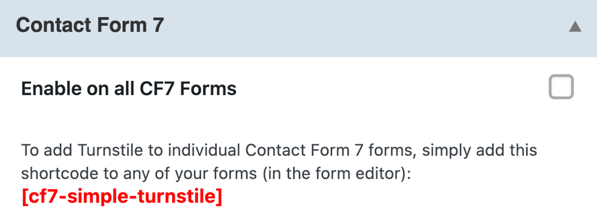

Try reactivating the SCT plugin and inserting this shortcode [turnstile] right above [cf7-simple-turnstile]. Then, the two Turnstile captchas should appear together. Therefore, the first Turnstile at the top of the form is from CF7.Hi, I use Contact Form 7 (v. 6.11) and Simple Cloudflare Turnstile (v. 1.32.3) and I have a similar issue to William’s.
I would like to use Turnstile on forms only using the CF7 integration. I also want to keep Simple Cloudflare Turnstile active to protect logins, passwords, and comments. Therefore, I didn’t enable the SCT option on all CF7 forms (image below), thinking that this would only apply to forms that use the [cf7-simple-turnstile] shortcode. However, configured this way, I see the Turnstile confirmation, but the form fails to submit. My tests:
1) Disabling the SCT plugin and using the CF7 Turnstile integration, the form submits normally.
2) With the SCT plugin active, “Enable on all CF7 Forms” NOT checked, and using the CF7 Turnstile integration, the form does NOT submit.
3) SCT plugin active, “Enable on all CF7 Forms” checked, and using the CF7 Turnstile integration with the [turnstile] shortcode, the form is NOT submitted.
4) SCT plugin active, “Enable on all CF7 Forms” checked, and using the CF7 Turnstile integration with both the [turnstile] and [cf7-simple-turnstile] shortcodes, and the form is SUBMITTED NORMALLY – obviously displaying two CF Turnstiles.Shouldn’t the Simple Cloudflare Turnstile plugin (with the “Enable on all CF7 Forms” option NOT checked) ONLY check CF7 forms when the [cf7-simple-turnstile] shortcode is applied to the form?
For now, to get the desired result, I’ll continue using option 4 above.
