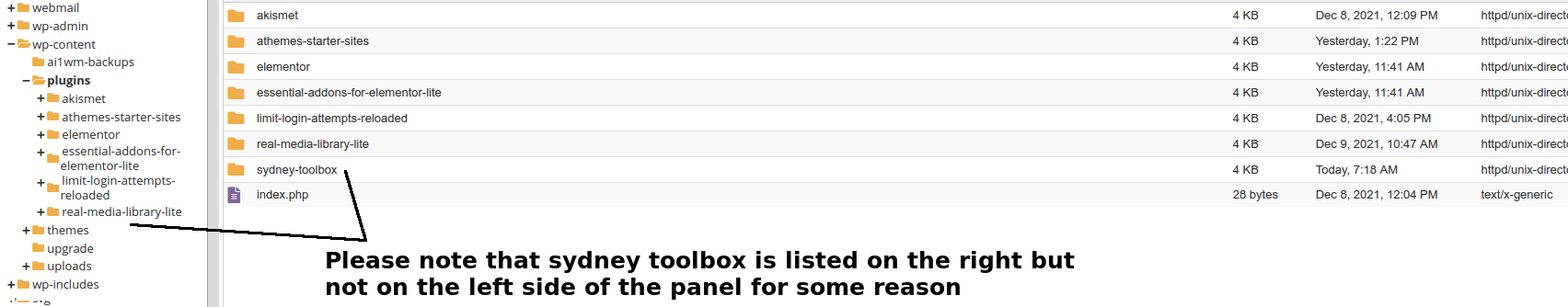

In reply to: [Sydney] Sydney Toolbox fatal error@kharisblank My sincere gratitude for your attention. The version of sydney toolbox I have installed is 1.18. Fresh install of wordpress 5.8.2. I did exactly as you recommended several times. I manually deleted the plugin and reinstalled the latest version. I get the same warning of fatal error.
Fatal error: Uncaught TypeError: call_user_func_array(): Argument #1 ($callback) must be a valid callback, class "sydney-toolbox" not found in /home/public_html/surcp.org/wp-includes/class-wp-hook.php:303 Stack trace: #0 /home/public_html/surcp.org/wp-includes/class-wp-hook.php(327): WP_Hook->apply_filters() #1 /home/public_html/surcp.org/wp-includes/plugin.php(470): WP_Hook->do_action() #2 /home/public_html/surcp.org/wp-admin/plugins.php(193): do_action() #3 {main} thrown in /home/public_html/surcp.org/wp-includes/class-wp-hook.php on line 303One interesting item to note. In the cpanel file manager I select the plugins. The panel on the right shows the plugin. The plugin directory on the left does not. Here is a link to a screenshot: http://surcp.org/sydney_toolbox.png
