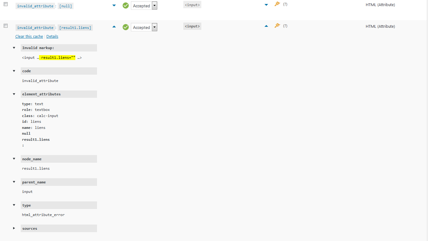

    I would say after further research/testing this is a Yoast SEO plugin issue conflicting with the AMP plugin and not a core issue with the AMP plugin itself.
    All but 1 error comes from Yoast SEO Premium, so that plugin is reporting validation errors where there are none.
    I wish there was a way to just choose to ignore those errors and have AMP still be enabled. Yoast doesn’t know what they are talking about (as usual).
    Below is a link to an image of the errors
    https://reverse.mortgage/imgs/screenshot-2019-07-18-09-46-14.png
    Thread Starter stevenbradley
    (@stevenbradley)
    Well the problem is that the code that is being reported as having AMP errors doesn’t really have any according to google’s own AMP validation tool.
    So when I choose accept it removes what it thinks is bad code and then the form on the page doesn’t work right. The form uses AMP states (bind) to change certain values.
    Below is output for one of the errors, it looks like another plugin may be marking this as an error and then the AMP plugin is following that?
    <input … result1.liens=”” …>
    code
    invalid_attribute
    element_attributes
    type: text
    role: textbox
    class: calc-input
    null
    result1.liens
    node_name
    parent_name
    input
    type
    html_attribute_error
    sources
    “type”: “plugin”,
    “name”: “wordpress-seo-premium”,
    “function”: “WPSEO_Frontend::flush_cache”,
    “hook”: “wp_footer”
