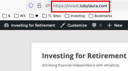

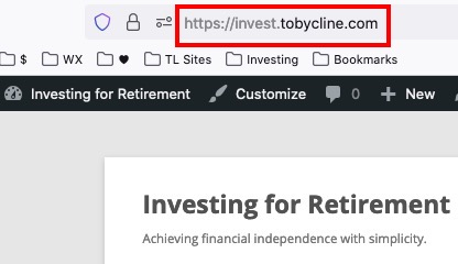

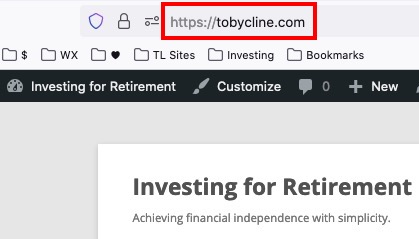

    My domain with my name forwards to the investing site no matter where I put the investing site, lol. This is crazy!
    When I place my investing site in a sub domain of my main multisite domain, the http://www.myname.com forwards to that sub domain. See here.
    When I place my investing site in a sub domain of my mapped domain, the http://www.myname.com forwards to that sub domain. See here.
    Finally, when I set my investing site to my mapped domain, it stays put, seen here.
