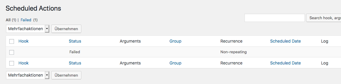

In reply to: [WooCommerce] ActionScheduler Error – Unable to get rid ofActually the list of scheduled actions lists one failed, otherwise it’s empty:

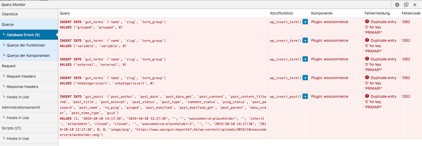

List of Scheduled Actions, 1 Failed, Otherwise EmpytI have also installed Query Monitor as this was recommended somewhere to check for possible problems and found these when activating Woocommerce:
Query Monitor Plugin: Database Errors

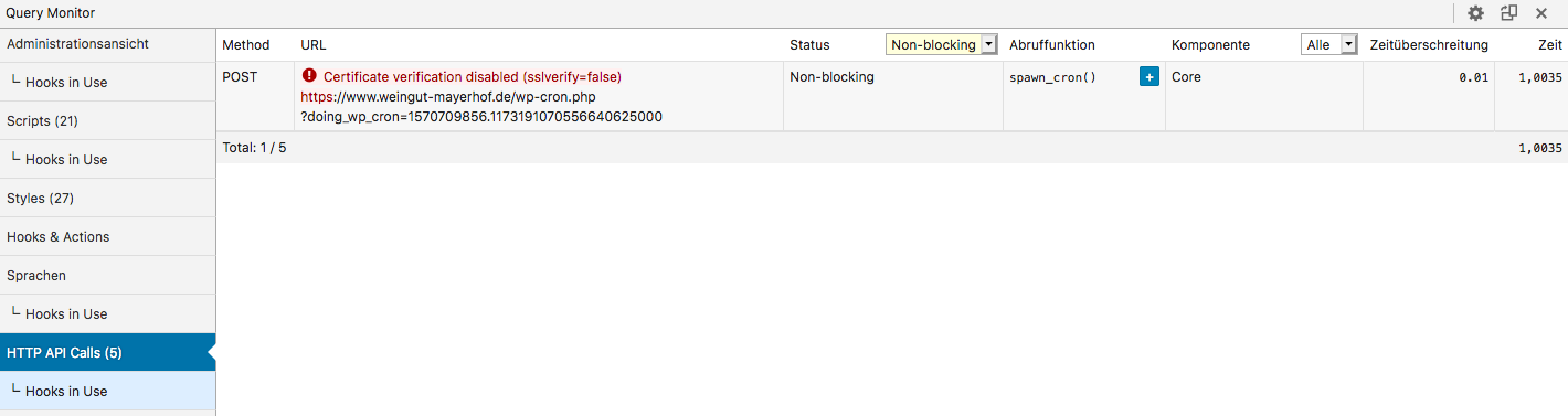

Query Monitor: API Calls SSLverify errorThe database error might be a separate problem from Action Scheduler. Could the latter one have something to do with my provider/hosting settings? Possibly restricting loopbacks in wp-cron?
