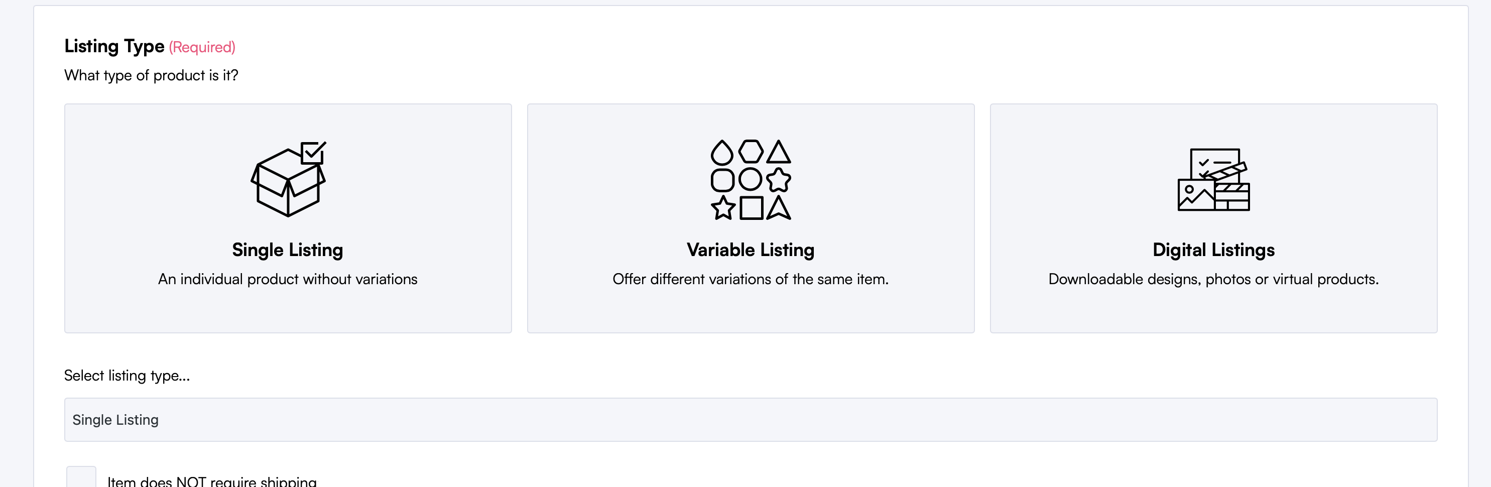

Hi there,
Thank you for reaching out,
Regarding the UX around adding products: I see what you mean. We used the default WooCommerce UI but that can certainly be made in a simpler and more streamlined way.
We are open to adding an additional UX as an option, i.e. some kind of simple / step-by-step UI – we would consider that for future updates. That said, I wouldn’t be able to give a specific timeline for that as it’s quite a complex addition.
I would like to mention that if you’d like, it is possible to customize the PHP template of that page (it would be needed to work with a developer). By doing that you can achieve any kind of custom design around adding and editing products. All pages on the vendor dashboard have customizable .php templates that can be overwritten with your own, to change the design. Some of the shops using MarketKing have indeed designed and implemented their own custom flows around adding and editing products.
