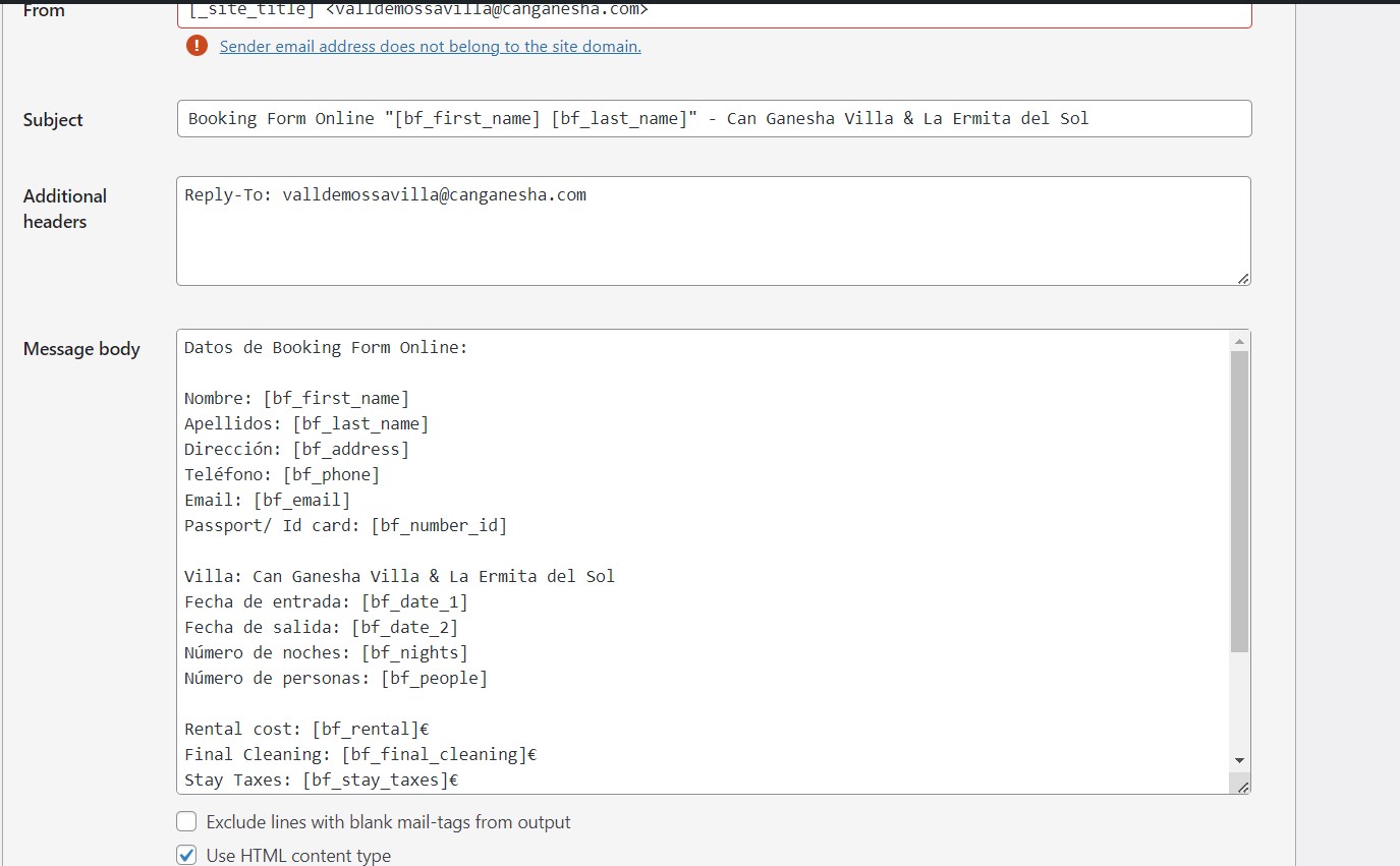

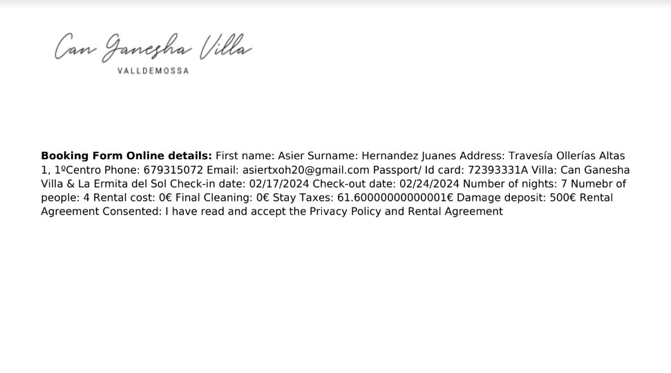

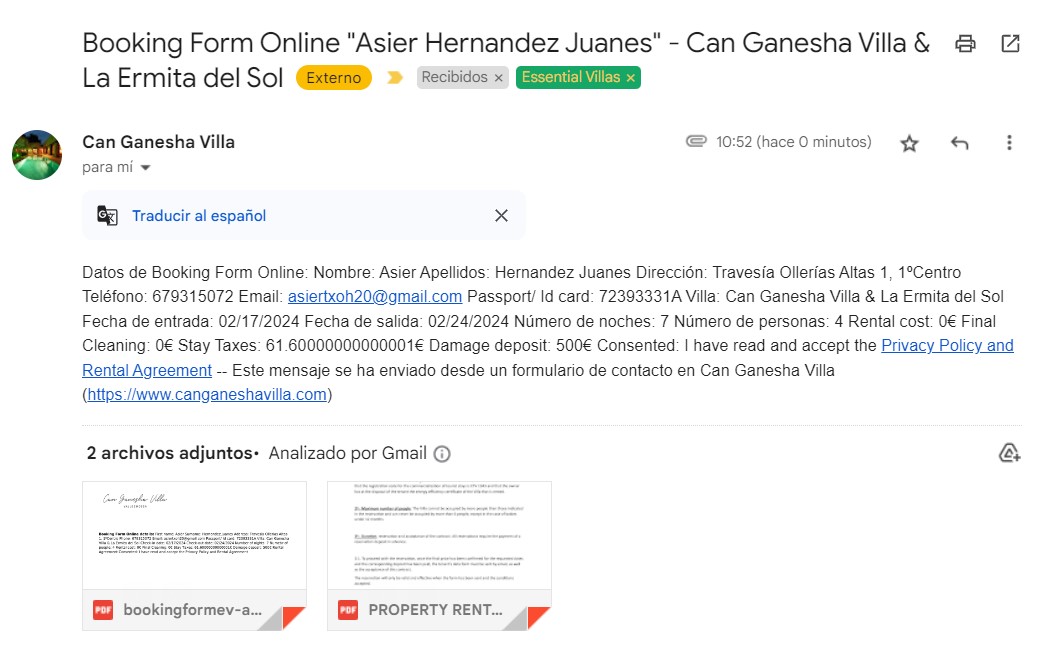

In reply to: [Send PDF for Contact Form 7] PDF break lines not workingHello,
I am still having the same problem with the last version of your plugin. Here are my examples:
In reply to: [Send PDF for Contact Form 7] PDF break lines not workingThis option (“Use HTML content type”) was already checked.
Everything was fine until the last updates of the plugin.

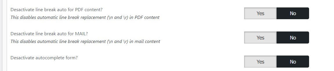

In reply to: [Send PDF for Contact Form 7] PDF break lines not workingHello again,
The email and the PDF both are showing without the line breaks.
I saw this 2 new options but any combination of this options is showing the PDF preview without the line breaks.
