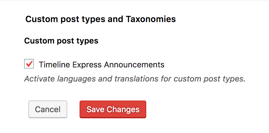

In reply to: [Timeline Express] Can this work with Polylang to have Two Languages?I just confirmed that I am seeing the post type listed in the polylang settings:
https://cldup.com/BQZdPFpyWc.pngYou will also want to confirm that the read more links are visible.
In reply to: [Timeline Express] Can this work with Polylang to have Two Languages?You’ll need to enable polylang on the custom post type, in the polylang settings page.
See the following polylang documentation:
https://polylang.pro/doc/multilingual-custom-post-types-and-taxonomies/If you don’t see the Announcements listed there you will want to head into the Timeline Express settings page and set the ‘Exclude Announcements from Site Searches’ setting to ‘False’ and re-check. Once you’ve enabled polylang support on the announcements you can re-set ‘Exclude Announcements from Site Searches’ to true (or whatever you would like).
