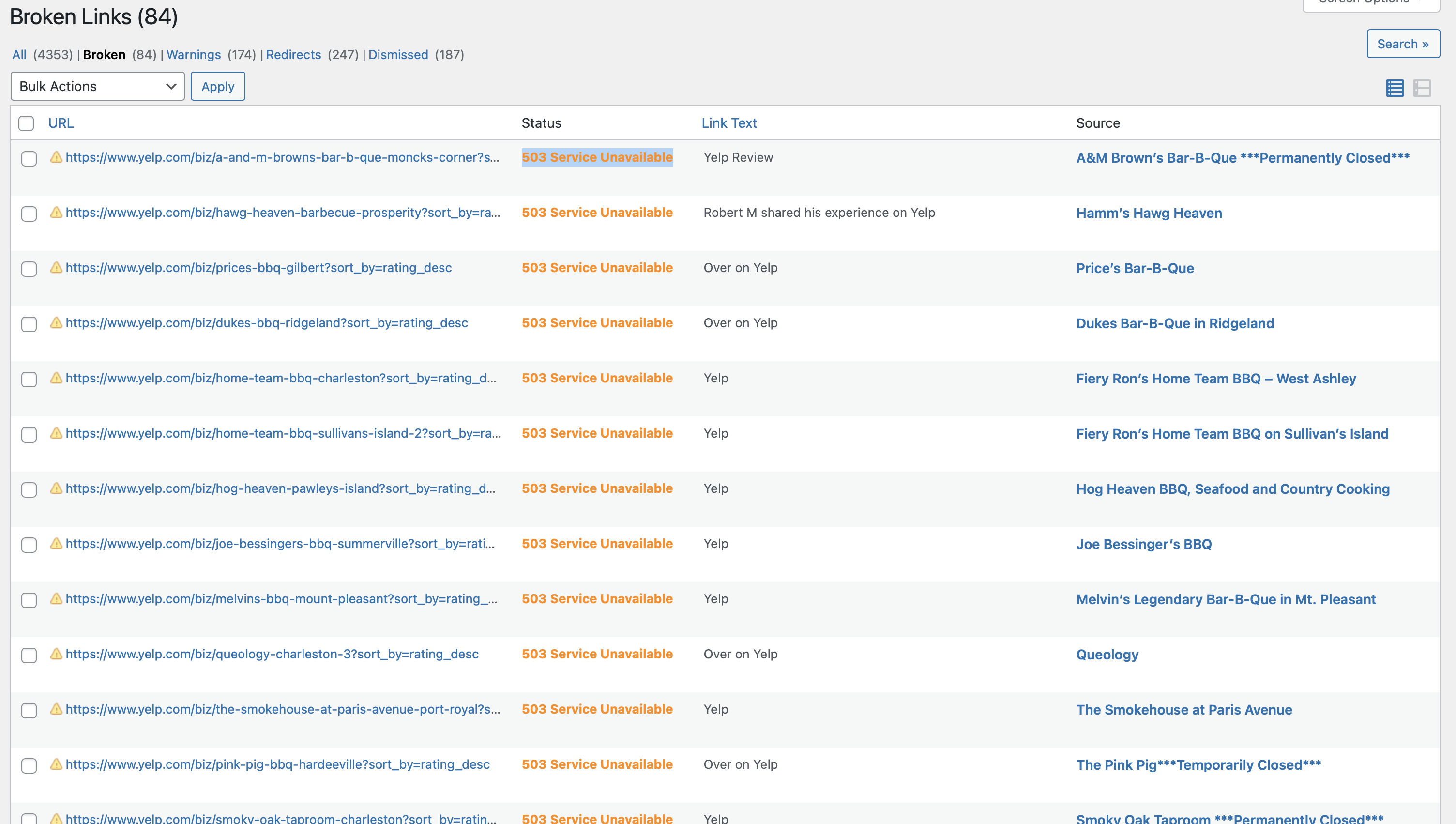

In reply to: [Broken Link Checker] Yelp Links = 503Thanks for the feedback. I have tried what you suggested, but rechecks don’t seem to resolve the issue.
In reply to: [Broken Link Checker] Yelp Links = 503Sorry…I never saw the initial reply. Here is the link to the screenshot:
https://destination-bbq.com/wp-content/uploads/2023/01/Screenshot-2023-01-08-at-8.10.55-PM.png
I currently have 41 new broken links. As before, one is an Amazon short link while the rest are Yelp links. Here are a few that are currently listed as 503s:
https://www.yelp.com/biz/the-spotted-pig-bbq-fair-play?sort_by=rating_desc
https://www.yelp.com/biz/521-bbq-and-grill-tega-cay-2?sort_by=rating_desc
https://www.yelp.com/biz/bellys-southern-pride-bbq-and-catering-lexington?sort_by=rating_desc
