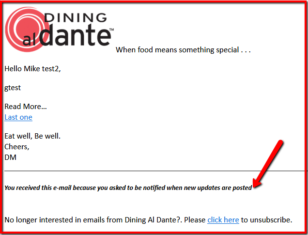

Well I’ve narrowed down the problem again. Seems as if a Period(.) at the end of a sentence at the end of the template is causing things to NOT send. The same sentence, with the period in the middle of the template sends fine.
http://mikemartinelli.com/PiMP/Dante.png
See the arrow – if there is a period here it will NOT send.
This goes for a post notification or a newsletter…
