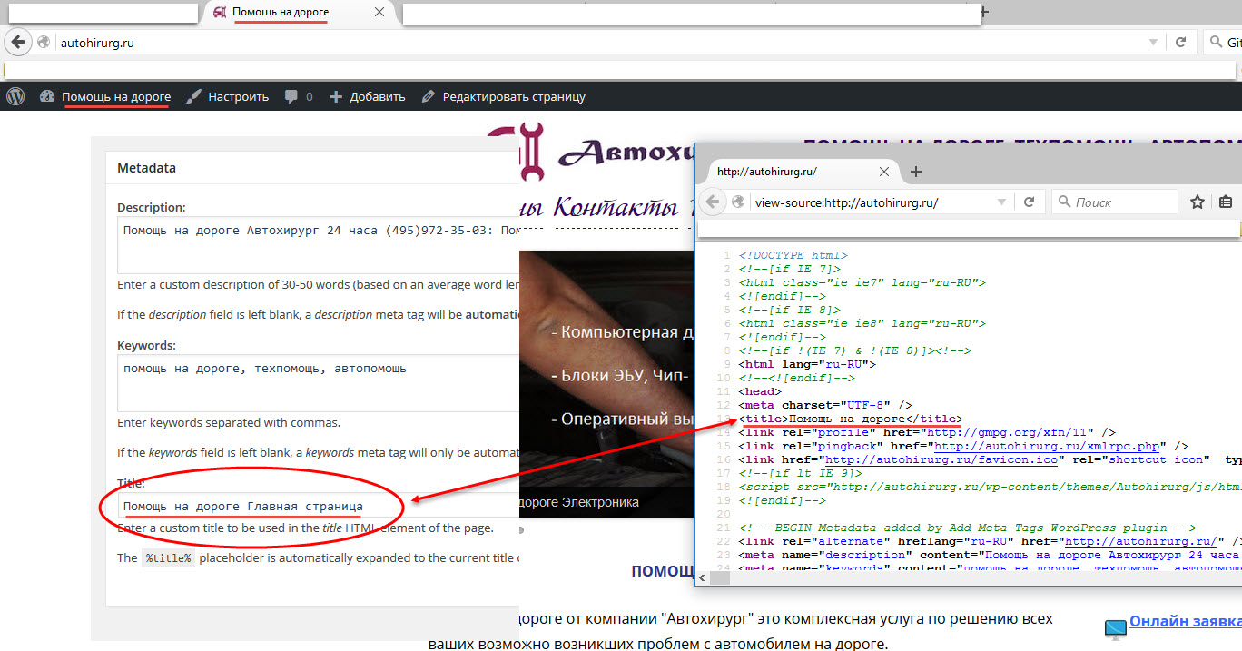

    Thread Starter rpaff
    (@rpaff)
    I apologize, my English was not so good that i would clearly articulate the idea. I will show my site as an example of this situation.
    Example: Image
    On the picture you see the title I entered in the settings of main page. Also in the picture you can see that custom wordpress title overwrites the title is written in the settings page in the add meta tags plugin. This happens even with enabled option “Advanced Title Management”.
    Thank you for support.
