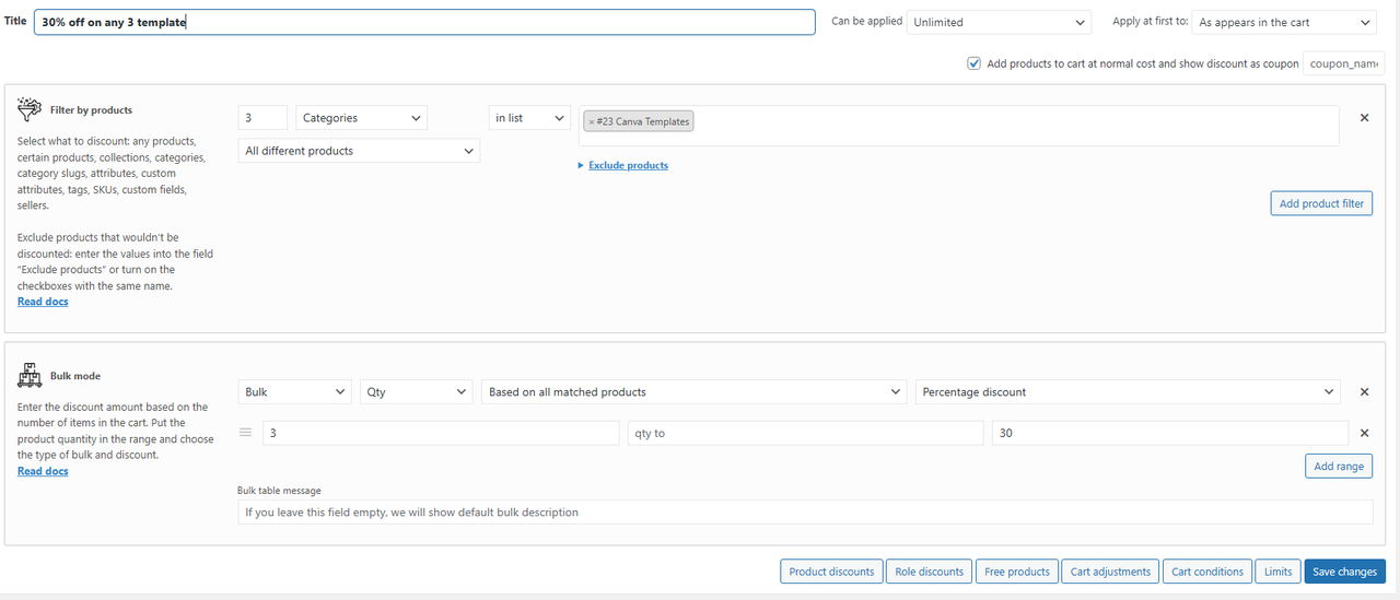

I’ve opened a question on WooCommerce regarding the empty cart issue I’m experiencing when I check the “Limit purchases to 1 item per order” option. Could you please take a look at their response? They mentioned that the problem I’m facing is caused by the Advanced Dynamic Pricing plugin.
Could you please try to replicate the issue and see why your plugin is causing trouble when I enable the “Limit purchases to 1 item per order” option in WooCommerce?Regarding the screenshot, I’m not exactly sure how to set up the plugin to achieve the following: if someone buys 3 or more products from a specific category, they should receive a 30% discount.
Please ignore the bulk settings because the “Limit purchases to 1 item per order” option, if it worked correctly, should allow purchasing one unit from any product. However, if a person wants to buy 3 or more different products from the category, they should receive a 30% discount on all the products.
Since I didn’t know how to set this up properly, I chose the bulk option, but maybe I need to configure it in a completely different way.
Hi thanks for the answer, here is my rule:
https://i.postimg.cc/FsD4Zjp4/Screen-Shot-20241230224640.pngForum: Plugins
In reply to: [WooCommerce] empty cart when Limiting purchase for downloadable productWhen I disable the Advanced Dynamic Pricing for WooCommerce, the empty cart still persists. I need to uncheck the option to “Limit purchases to 1 item per order” for all items that were previously in my cart. After doing this, the cart starts working again. I can then re-enable the “Limit purchases to 1 item per order” option, and it will work fine until I re-enable the Advanced Dynamic Pricing for WooCommerce.
Take a look at the image; this is my current setup for Advanced Dynamic Pricing for WooCommerce.
