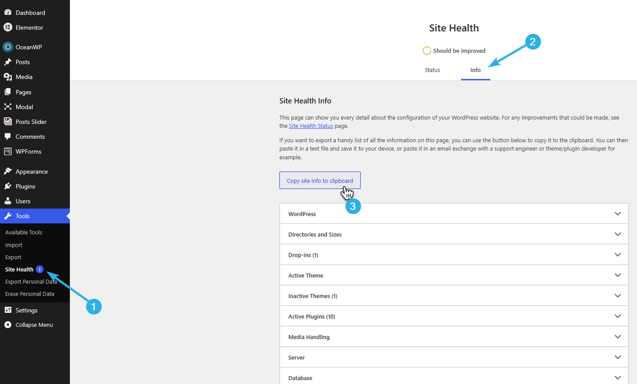

    1. When did you first notice the issue, after a specific update, on a particular device, etc.? and what are the exact steps that trigger it? Screenshots or a short video are very welcome (Loom, Postimages, Google Drive, Dropbox, etc).
    2. Explain to us step by step how we can reproduce the issue so we can recreate it somewhere other than your website.
    3. Your system environment info: go to WP Dashboard > Tools > Site Health > Info tab and click “Copy site info to clipboard”. Paste it here as code or share via https://pastebin.com or https://gist.github.com (you can remove your email from the content).

    1. Please provide your system environment details so we can dig deeper. Go to WP Dashboard > Tools > Site Health > Info tab, then click “Copy site info to clipboard”. Screenshot: https://i.postimg.cc/V6Z6hQ3V/image.png. You can paste it here as a code block, or share it via Pastebin or GitHub Gist (feel free to remove your email address before sharing).
