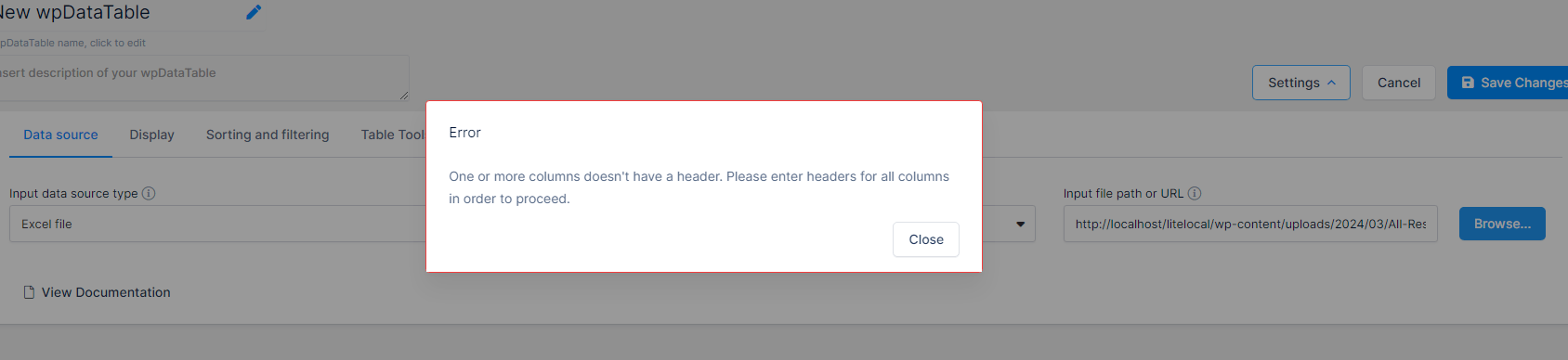

    Plugin Author wpDataTables
    (@wpdatatables)
    Hello again,
    We are just following up; happy to report, our developers made a new fix for this issue.
    It is still in the testing stage.
    We will share the instructions on how you can edit our Lite Plugin’s code to apply the fix.
    Find this PHP file via FTP or your Hosting File Manager or the Plugin File Editor, in the path :
    ../wp-content/plugins/wpdatatables-lite/source/class.wpdatatable.php.
    Then around line 1754 search with “CTRL+F” for this line :
    $headingsArray = $objWorksheet->rangeToArray('A1:' . $highestColumn . '1', null, true, true, true);
    Under it, add this :
    while (!end($headingsArray[1])) {
        array_pop($headingsArray[1]);
    So in the end, that part of the code should look like this :
    Save changes, and purge cache of your Site, then try to load the existing Table/ or link a new Table from the same file and now it should work without throwing the error about empty Headers.
    We have one sample Excel from one of our users who sent us a file, we can confirm it works when this fix is applied on both Lite and Premium Plugin versions.
    Before the fix – on our latest Lite/and Premium plugin versions, this file was throwing that error “One or more columns does not have a Header”
    and after the fix applied, it is not throwing any errors.
    So we tested the fix works on the files we tested so far, but we can use your help if you can send us your files to make sure.
    This fix should be included in the next Update, but we can’t guarantee the exacet ETA because our QA Team is still conducting final tests to ensure there are no negative effects before it is added to the Plugin’s core and we wish to try to make sure it works on all the files and use-cases as it should be.
    So if you can try this fix, then let us know if any of your source files (CSV/Excel) are still not working with the existing or new Tables.
    If that is the case, can you please send us your source files here so that our developers can work on an improved fix?
    If the source CSV/Excel does not contain any sensitive Data, you can just upload it to weTransfer and send us a download link here;
    Or if it has any sensitive Data, please open a Private Pre-Purchase Ticket on our main Support platform here, then our Agents can take your file and we can perform testing in order to help our developers build an improved fix that would work on all your files.
    Let us know how it goes, we will keep following up.
    Thank you.
    (@wpdatatables)
    Hello everyone,
    We are happy to report, our developers made a new fix for this issue.
    As mentioned above,
    Thank you.
    With this sample Excel, we can confirm it works when this fix is applied on both Lite and Premium Plugin versions.
    This fix should be included in the next Update, our QA Team is just conducting final tests to ensure there are no negative effects before it is added to the Plugin’s core.
    If any Lite/free Plugin user comes across this, and if the fix does not work for you, feel free to open a new Post and send us your source file there;
    Or if it has any sensitive data, please open a private Pre-Purchase ticket on our Main Support – so we can debug the issue there.
